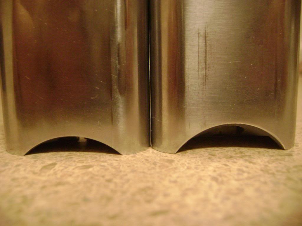

Pic for reference. Left is the keihin 4.0 right is keihin 6.0

The idle is not the issue.. I am using the throttle adjuster to set idle. The problem is when I am riding and crack the throttle from closed to wide open it bogs down for a second. I could not get it right with jets, needles, clip positions nor the air screw.
Then I tried the carb and slide from conquest's blaster and I had mine running perfect in a couple hours of jetting/test riding.
When we pulled everything out we instantly noticed that the taper on the slides were different. After looking at keihin part lists they aparently have 5 different taper cuts going from rich to lean (4.0 rich to 8.0 lean)
My slide is a 4.0 which explains the bogging. His slide is a 6.0 which keihin notes as the standard slide.

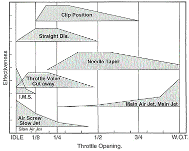

Another image i've found reguarding what affects what with tuning keihin carbs specifically. It may be generic with all 2 stroke carbs but im not sure.
