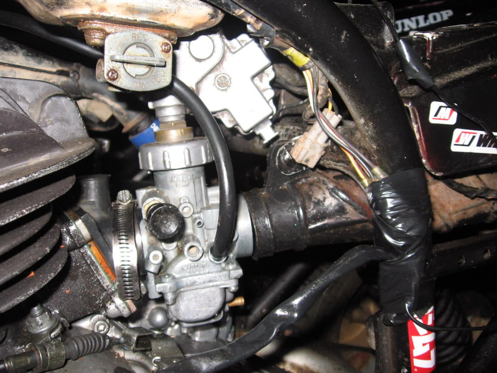

why wont the air box boot reach (pic)

anybody else got this problem i cant get it to reach.
its prob the plastics to far away cause it connect to the boot try pushing the rear plastics forward this happened to me and thats what i did.
Maybe you could try to heat it up a little with a heat gun or something to make it a little more "workable". I don't know if that's the best option, but may be worth a shot if nothing else works.
ive got it connected i took the carb and hooked the intake boot up first then pulled it to the motor and it didnt move when i put it in the groove so we are good :)
glad you got it on. i ran into this problem too so i took the dremel to the six bolt holes in the plastic and made them into slots to slide the plastic forward enough for an easier connection
