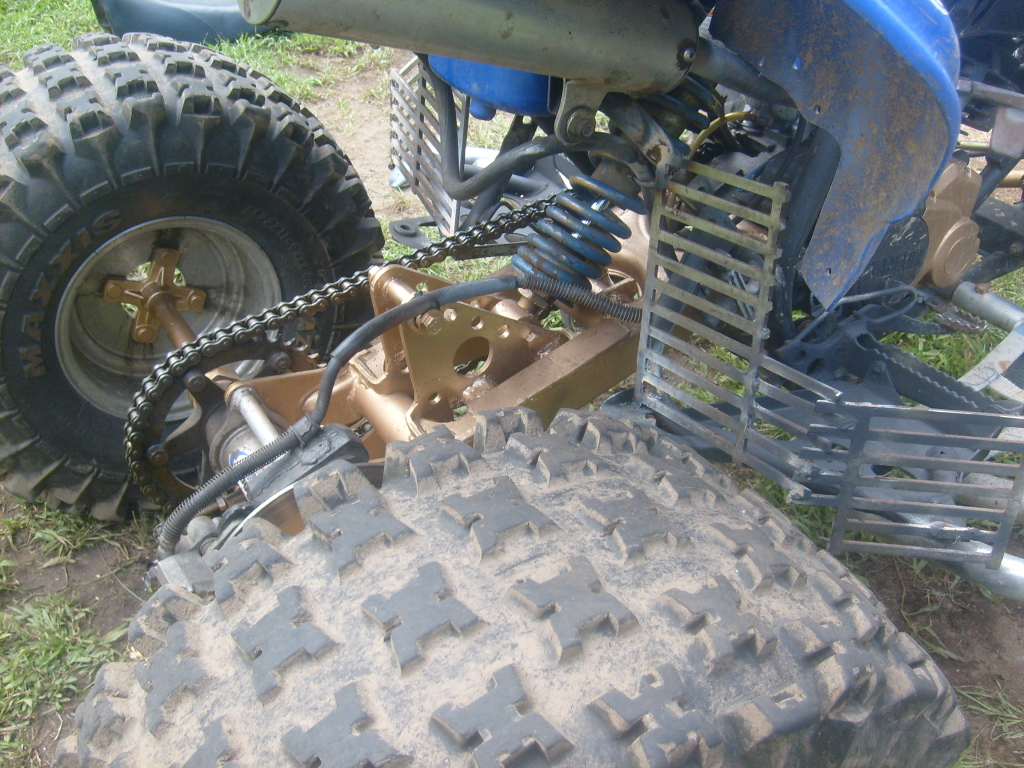

I run a +4 with the shock mount in the stock location with a trx450r shock. rides awesome and I like the lower center of gravity
Have him make a plate with adjustable mounts.Giving you 5 different settings,that way u can fine tune it for different riding,I did mine like that and love it.
