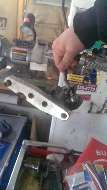

what is this?
Jhabeeb
Jul 25, 2011
152
6
55
Burlington, Mass
hey guys so this brake setup was on my blaster and im just trying to figure out what it came from? my blaster predates hydraulic setup. also was wondering if it would be worth anything to sell or just scrap because I just got some awk brakes
thanks
Looks like a bracket of some sort for the rear brakes. I know some companies made conversions to run hydraulic brakes on the 88-02 years.
That's the East Coast ATV bracket to mount a Banshee or 03+ Blaster caliper rigid to go with the early carrier and floating disc. It works very well. I had one on one of my Blasters before I went to roundhouse carriers on everything.
