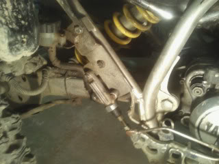

Heres the hydro brakes i have. came on my blaster not sure what they are. when i first got it had the guy put pads in it he said he just put stock pads. it looks like a factory caliper. Its all bolted on and the brake line is f'in huge like 2 feet long. heres a sh*tty vid can get a better if need be. I need help fixing had 2 diff mechanics look at them and they cleaned the caliper with new pads but both times froze up a coulple rides later. The peddle goes in but the plunger acts like it doesnt work.
That has to be about the worst video quality I've seen in a long time...LOL
As to the brakes, it looks like something custom... the master cylinder is a nissin (same thing like every Japanese sport quad and sport bike use) but the master cylinder bracket looks homemade.
If that's a nissin caliper, it's leaned the wrong way. Most are designed to have the bleeder screw at the top when the caliper is behind the axle not in front.
The caliper bolts the the stock bracket. The bleeder lookes like its off to the side and 2 good mechanics used stock pads? looks like a stock caliper also from what ive seen. heres a pic and i posted a diff vid.
if you say that if you push the pedal in but it doesnt brake then they need bled, as far as them freezing up wrap them up tight to keep them warm, haha, jk but take it apart and clean the piston in there. then youll have to bleed them for sure.
well they worked fine for a few rides then just locked up and let it sit and they came on frozen ever since then i used them and they stuck so i just used fronts now they just dont work at all

i have no clue what that caliper is, and as civic stated it looks to be on backwards ???
possibly a stock 03+ caliper ???? on wrong ???
