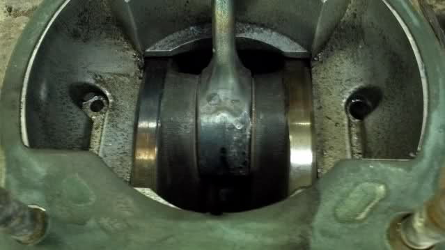

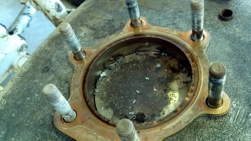

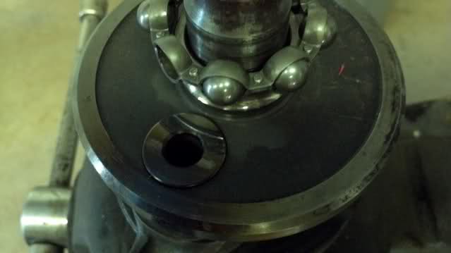

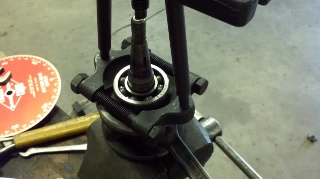

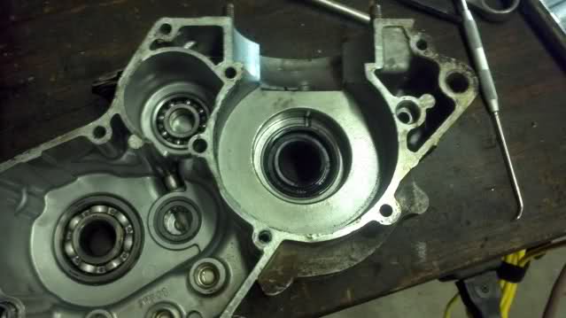

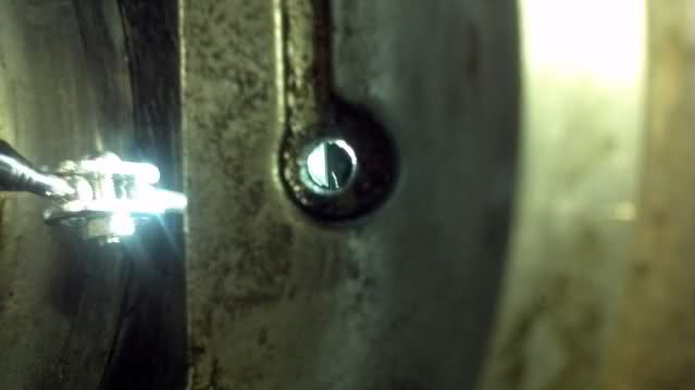

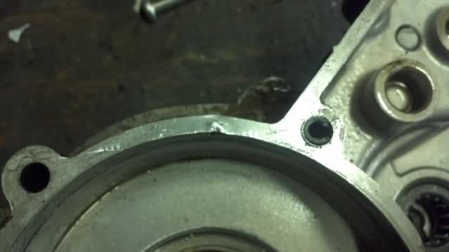

History' Bought a used one with a rebuilt top end, because the oil injection quit and it needed rings, so they said, IT ALSO NEEDED, new bearings,and so on. The main crank bearings were wibbly wobbly and the main rod bearing was shot then the rod got over into the crankcase and chewed the sh*t out of it didnt punch through but did a nice gouge job all the way around then those chunks lodged in the bearings and locked it up tight, there were even peices of aluminum shooting out the exhaust8-| and on top of the piston when i pulled the head off. And sitting there looking at it with the cylinder off wondering if it bit through the case into the tranmission I came up with a getto leak down test procedure, i took the crankcase vent and blew in it and it held pressueer, so no leaks from the transmission to the crank or through the clutch side seals, thank god, tore it the rest of the way apart and found a brand new set of gears in the transmission, hot damn.

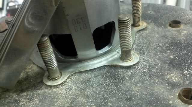

Wiseco doesn't make a stroker crank currently. Vito's markets their +3 and hot rods sells a +4.
You can have your cylinder head recut to accept the stroker crank without a spacer plate but unless you plan on porting the cylinder and having the cut cut all together, there is little risk from running a spacer plate (other than having twice as many base gaskets to potentially leak). Some builders even port cylinder for stroker kits making use the spacer plate....

Get a standard wiseco blaster piston in your current bore size (or the next bore up if you need one larger) and either run the spacer plate or get the head modified for the stroker crank. For maximum power the head needs to be modified anyway and it's just as easy to cut it for the stroker crank as it is to cut it for stock stroke (while someone has it anyway)

For the same port layout, the spacer plate "raises" the ports giving you more port timing.
Cutting the head "lowers" the ports, giving you less port timing BUTTTTTTT if you're going to get the cylinder ported for the stroker kit, the builder can work EITHER setup to optimum.
My point is with the getting the head cut, you don't have to purchase an unusual piston and even if you need to overbore, the head remains the same.
The top of the piston will only be 1.5mm higher in the cylinder at TDC with the 3mm stroker crank. The stock piston edge is nominally .8mm below deck height. The head gasket is .8mm thick. Raising the piston height at TDC by 1.5mm won't even stick the outside edge of the piston above the top of the headgasket. The head is actually cut not to allow space for the piston, but to allow space for the fuel/air charge. The piston SHOULD not hit the head with a 3mm stroker crank and no spacer plate but it will be .1mm from touching which would cause a catastrophic increase in charge speed and pressure which would result in detonation. There is a maximum speed fuel laden air can be pushed hot before you've excited enough fuel molecules to cause it to spontaneously combust (or "knock") the head is cut to allow enough space to stay under that "magic" speed.
with proper porting there is absolutely nothing wrong with running a spacer plate, thats how my motor was done and its been worry free and toons of fun I:I
Spacer plate vs. no spacer plate is really a builder preference. I like not having a spacer plate because it reduces one of the base gaskets... but if the engine is built around it, it should run like a scalded dog.

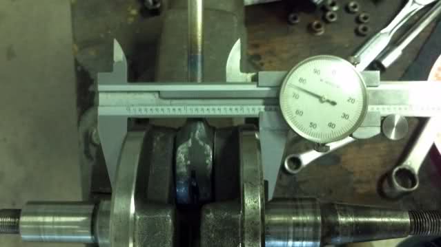

measure the stroke with a pencil in the sparkplug hole

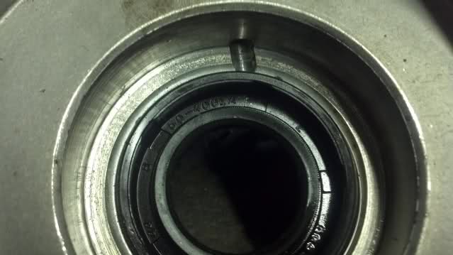

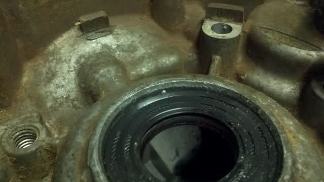

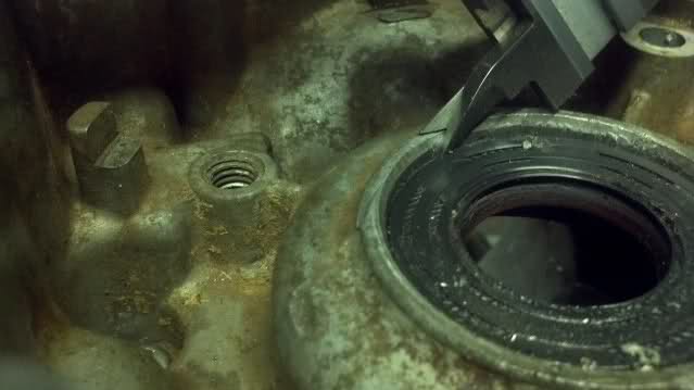

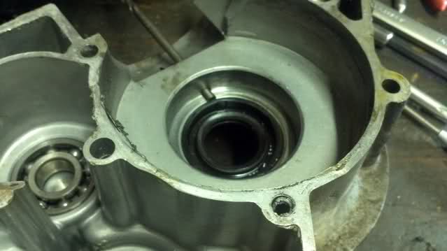

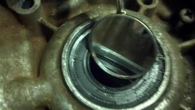

Looks like someone had a field day with that engine... Driving a crank seal in too far is an easy mistake to make if you don't know any better. There's no stop on that hole so you can easily drive it in too far. I ruined the first set I put in because I drove them in like that. Thankfully I know better now and don't go around jacking up engines anymore.
I think i might cut a notch in mine and glue them in with some indian head gasket shelauqer after i buff the rubber off the outside of them, "just in case"

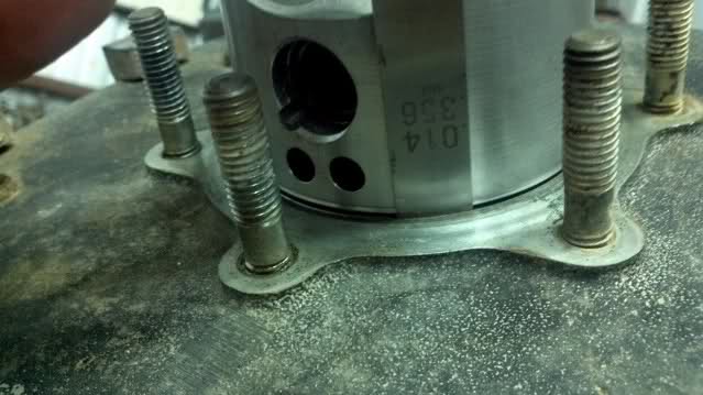

You don't measure piston to cylinder clearance at the top, BTW. The piston has a tapered towards the top to allow the piston to expand as it heats.
You measure the cylinder bore using an inside bore gauge and micrometer (or digital/dial caliper)
You then measure the piston skirt front to back 10mm up from the very bottom of the skirt.
I know,
but i could have measured this one like this with a popsicle stick, so i didnt bother diggin out the inside snap guages.:(
