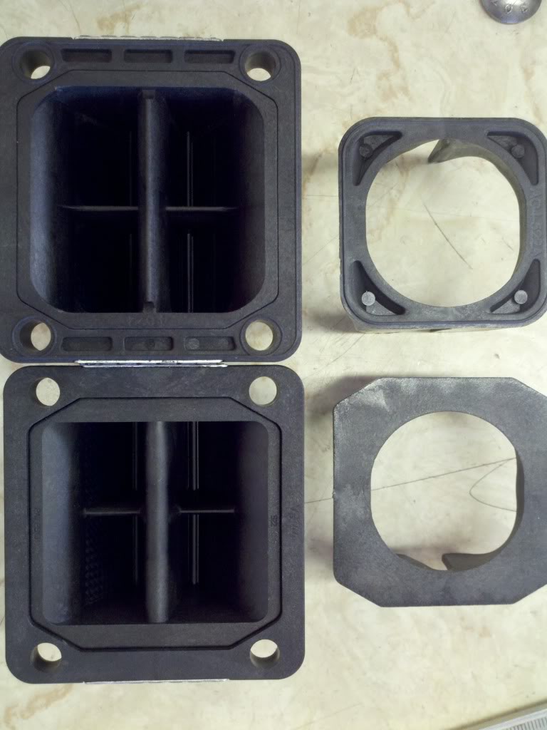

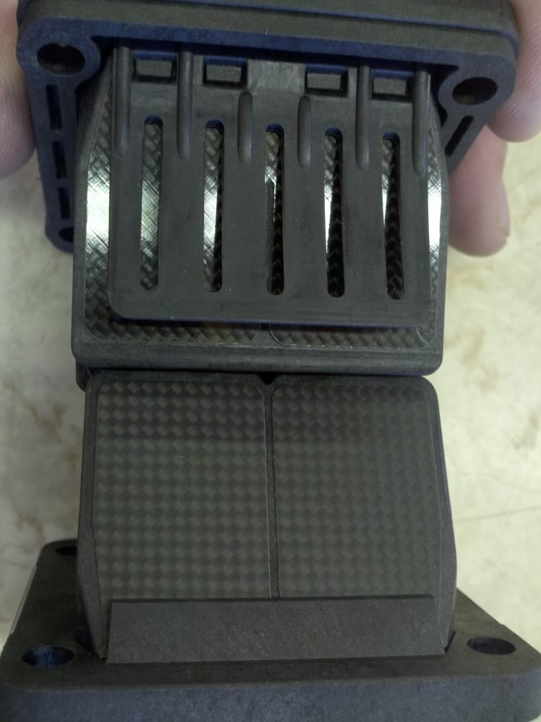

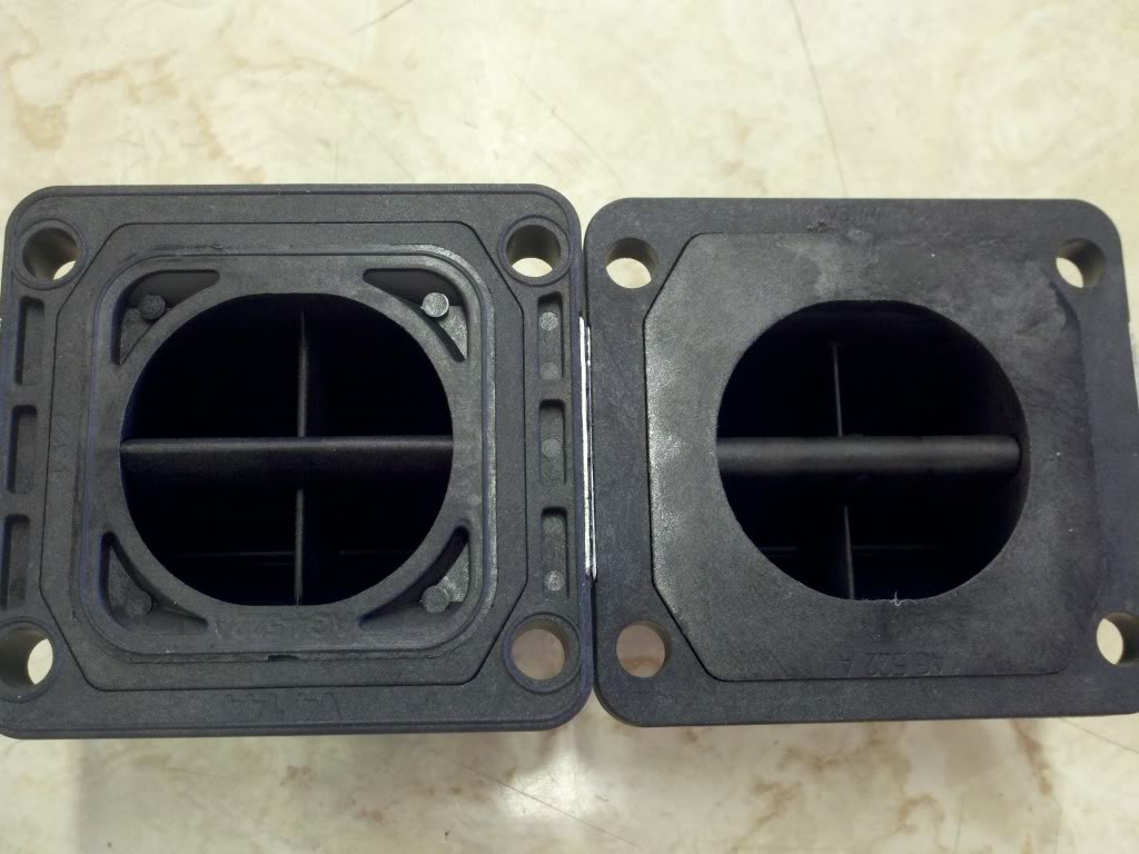

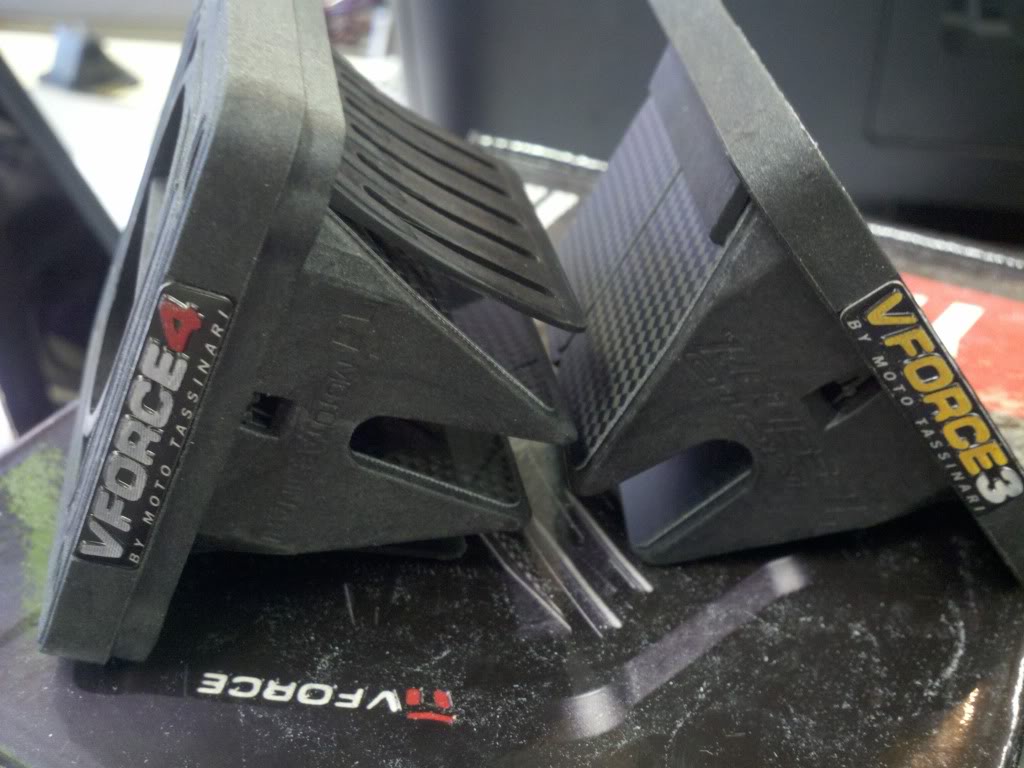

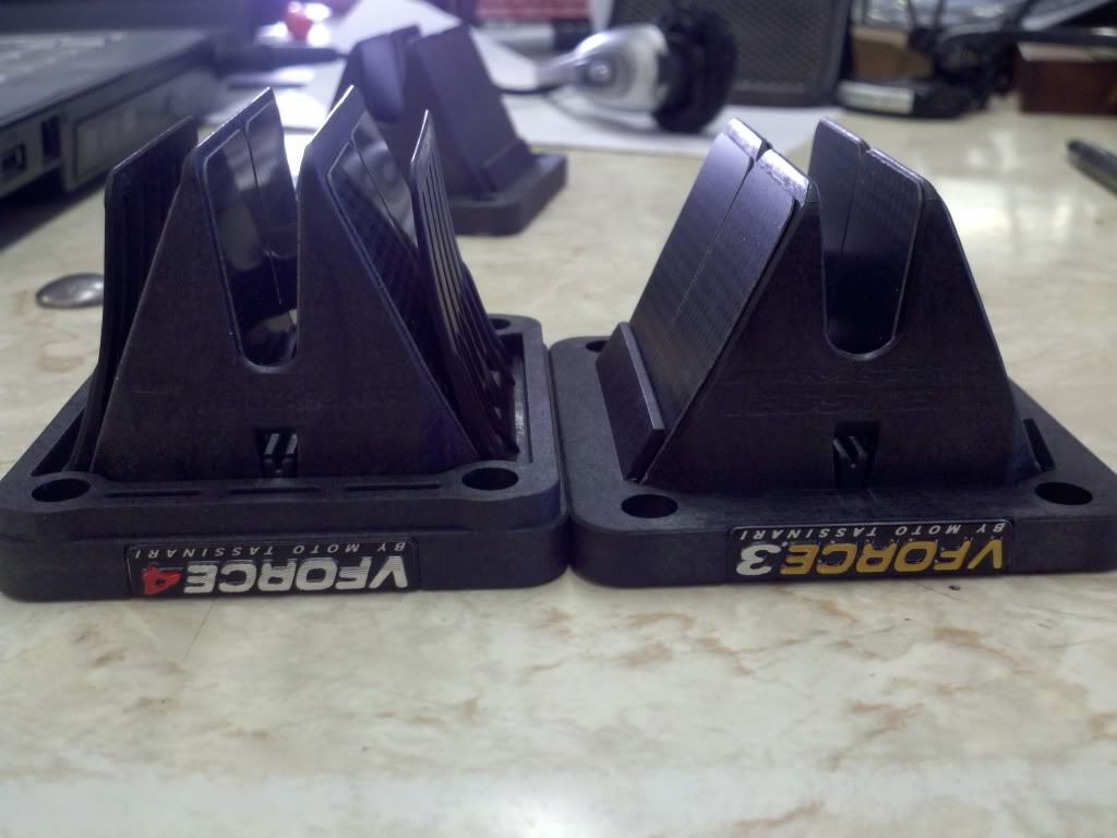

the 4's are on top and on the right in the pics vs. the 3's
First thing we noticed is if needed you can take the stuffer out and looks like you can run it without IF needed without buying the reed stuffers we carry. They also have a sealing lip around the carb side for better sealing to gskt surface.
The 2nd thing we see which is cool....is they are .060 wider overall than the vf 3s!! The petals measure about .035 wider EACH petal x 8 than the 3s!!!!
The air inlets are .025 wider behind each petal x 8 for more flow than the vf 3s.
Third pic is of the center airfoil which has been narrowed for more air flow.
They also have a built in spacer (.130 wide)...
[/quote]
Nice pics Joe! definetly changed the set-up possibly for the better, I see they added reed stops too. My Vf'3 with my hogged out mod is close to what they have done!
damn! i have ultimately refused to buy the vf3's just cause i didn't really think they were worth the asking price. seems like this vf4 set is actually worth buying though. i love the fact that they have a built-in spacer too. that means i could get rid of this separate spacer i'm having to use now. and they're cheaper!
might just purchase these soon!
