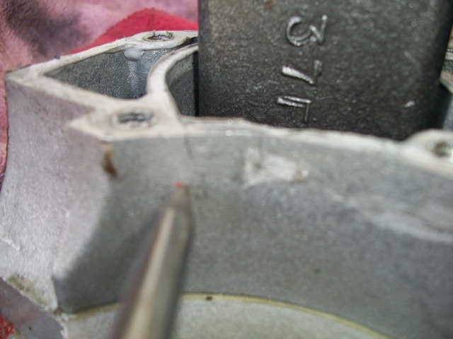

After doing leak down today. I tried for a few hours. I could not get it to build any pressure. First thought it was my gauge I made/ tester. Connections.
Nope.
So I split the cases and what did I find !!
Left case:
Nice size whole !!!
Right case:
Awl pointing to a crack.
Dont know if you can see, but two cracks on the right case.
Well looks like I need both cases. I am also wondering when I noticed the balancer was not in alignment. the dots not lined up. if this caused the cracks on the right case. Or also where part of that former piston skirt hit or both.
Clearer you can see the nice whole in the first pic of the left case, where the piston skirt part, damaged the case.
The good news, is the new piston and top end, still look brand new and in great shape. So no damage there.
I didnt think there would be any, cuz as I mentioned, when I did get it to run for a few seconds, it was smoking bad, sucking all that crankcase oil.
Was hoping it was a seal, but replaced them all earlier today and yesterday. But failed the leak test.

Ya $50 per case. I'll pass for now. I'm craxy and will try and use JB weld to make the repair. If it can last long enough, until I get that spare parts blaster with the good enging from my cousin. That would be just fine.

jb weld will not hold too much, heat pressure and fluids in there. do not try to jb weld it. you will just distroy more stuff. just wait until you can afford to fix it properly. half ass fixes cost 10x the real fix

I new the flak was coming. J/K,. You only looking out for what is right and should be done and I agree. Just did it this way for now.
I actually JB welded a case on a 2 stroke 40 horse evinrude outboard engine. it lasted 4 years like that. which was about 8 hours of engine run time a month, during the summer.
So, if it will last until I get that other motor. then Im fine with it, if it fails, it fails. Its also a good way for me to share with people on here, that its not the brightest thing to do, but it can work.
I used a dremel to grind the area of the crack, front and back and ruff up, before using JB weld on both sides. Also used acetone to clean area well, I did this 3 times.
The left case, with the whole., same thing, except for I did not remove crank and could not easily get into there to sand. I removed some of the material from the broken piece, along with the whoel area.
I did 3 light coats, layers of JB weld. build up. I added every 3 hours on back and front.
The broken piece, did leave it not flush. so some 400 grit sand paper,, made it even with the rest of the case.
