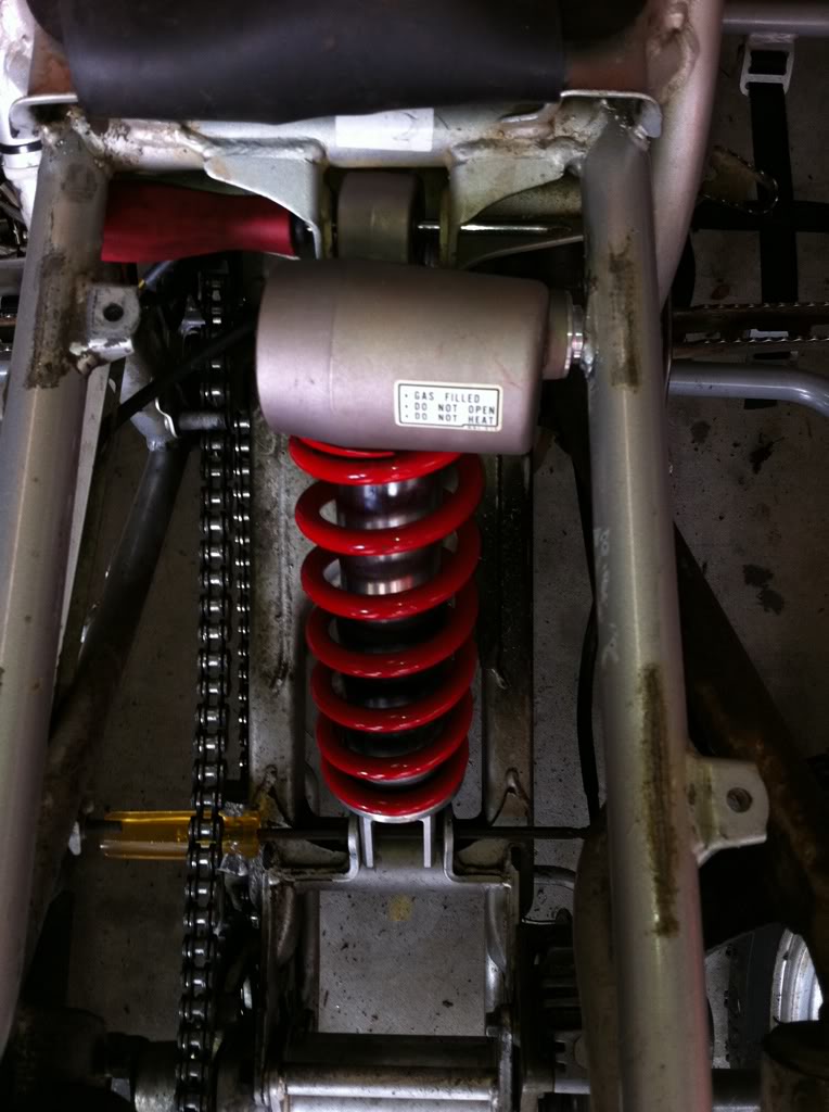

ok guys hes what im working on now
this is just so you guys can kinda see what it will look like
can someone post a pic like this of the 400 ex shock?
also is there a finished 450R pic yet? I'd like someone to take some measurements to determine if it will clear the factory 7 air box.
