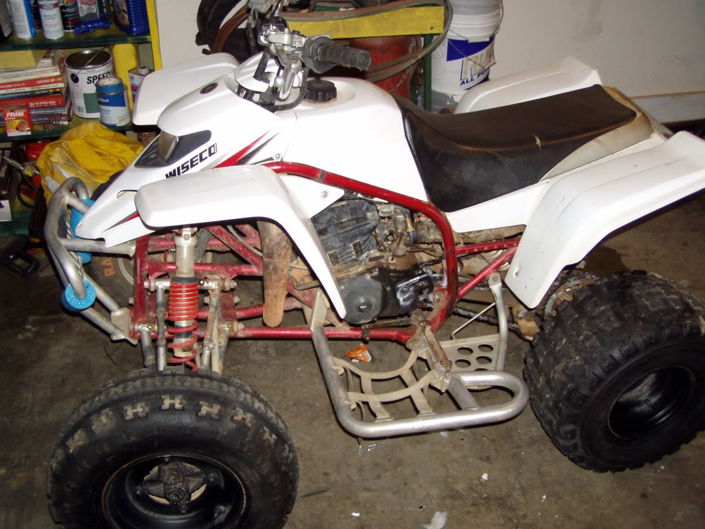

Well I just found out that the blaster has a wiseco piston...not sure of size, dg exhaust (is this any good?), and supposedly fox suspension all the way around (I assume this is good but I don't see anyone talk about it.

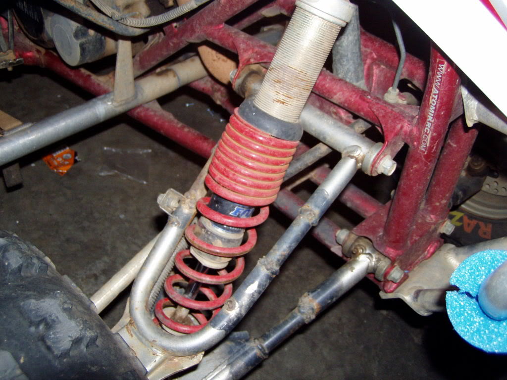

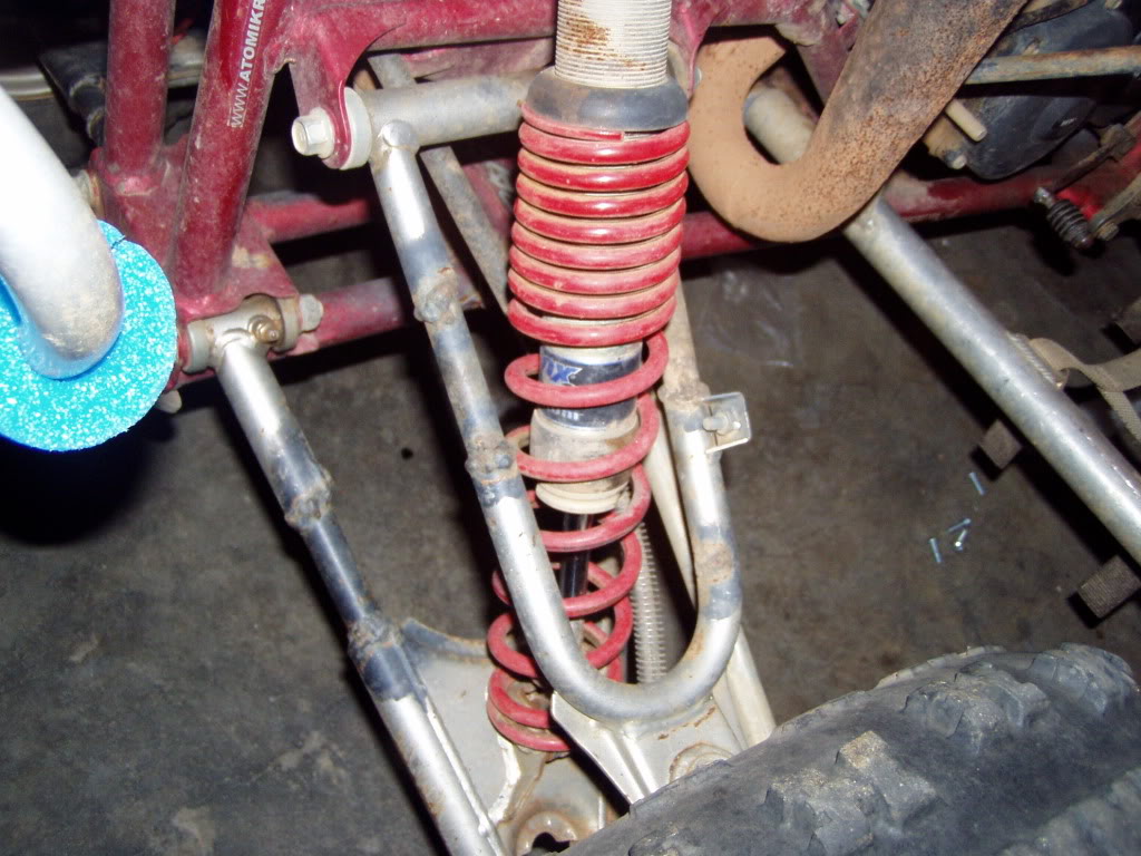

Ok so just got detailed pics and it does indeed have fox front suspension. Problem is the a arms were cut and welded to make them fit which means they need to be replaced.
If I measure the shock length, can anyone make me custom a arms for the shocks?
Post some pics of the arms. Unless they're a hack job with birdshit welds they are probably fine. Several on here have done it, at least one offers it as an economical alternative. I plan on doing mine here in the future. Try to get some info about them from the owner.
Got pictures....here are the two of the a arms and one of the whole quad. There are a couple things that probably need to be redone or have work done but the a arms are my biggest concern.
Wow, that's......... special. Like the shocks, fear the a-arms.
I make custom a-arms. Chromoly material, made to fit virtually any shock under 17" in length, replacable ball joints (big plus over extended stockers IMO), and replacement tie rods.
Also, something doesn't look exactly right..... I don't *THINK* that's a DG headpipe. The DG headpipes have a smaller diameter header section and don't diverge nearly as quickly. It may have a DG silencer on it, but that looks like a FMF headpipe. Also, DG's are raw finish usually coated black, not nickel coated like the FMF's.
Well if it is an fmf that would be good.
I do fear the a arms but I do nothave moeny for yours. How much do yours typically run?
That's EXACTLY the kind I wouldn"t ride on :o My guess on the shocks is that they are off a Polaris sled. They and Arctic Cat use Fox a lot, and Cats are usually green :D When you get them off get a length on them, cl of eye to eye. Shoot me a PM if you're looking to get rid of them. :D I:I
I was thinking something similar but the springs aren't very thick on those Fox's. Generally, the snomo shocks are setup to handle more weight aren't they?

I would worry about them a arms to. The added peace doesn't look to bad if your not jumping but I would be more worried about the ball joints seeing there angle was not corrected .
