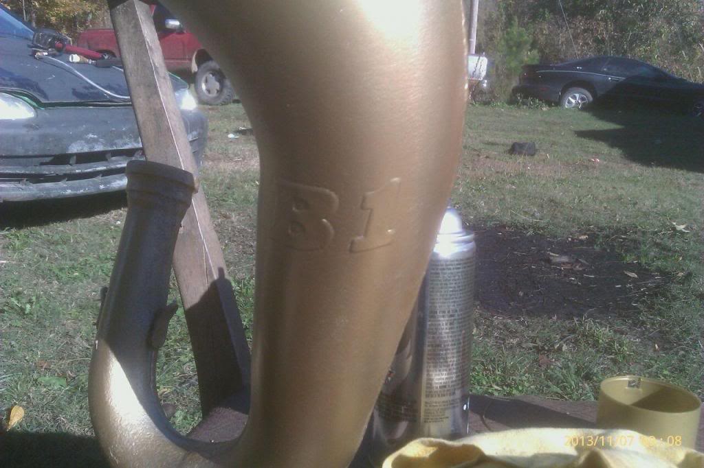

Ok so this whole time I thought my head pipe was stock.the thing is I don't believe it is.my bike came with the toomey badged uni filter.so I decided to sand the rusty head pipe n noticed I have the blue anonizded flange and b1 on the pipe.any toomey owners contest this is a toomey pipe
definately a toomey pipe.
be sure your jetted for it, i believe toomey recommends a 310-320
i get away with a 300 for the thinner air at my 1800'+ elevation
I think previous owner bought the whole kit because it's hot the 310 jet and air filter that comes in the kit.i bet they just bought the raw finish since it's cheaper
Took a drill and rust stripping attatchment to the head pipe today and it cleaned up real nice.if it would rust i would have left it alone but knowing better i got some oriellys engine enamel in gold.it dont really look that bad.pics to follow later today.
Also i went with gold bc im plannin on stealing the gold wheels off my shee for the lil blasty

I hope that is heat resistant paint and of the right temp or its going to peel really quickly. It looks really good though im diggin the gold!
Will do blaaster,gottA fix a crank seal first :( and thanx warmeck it is heat resistant its engine enamel from oriellys
