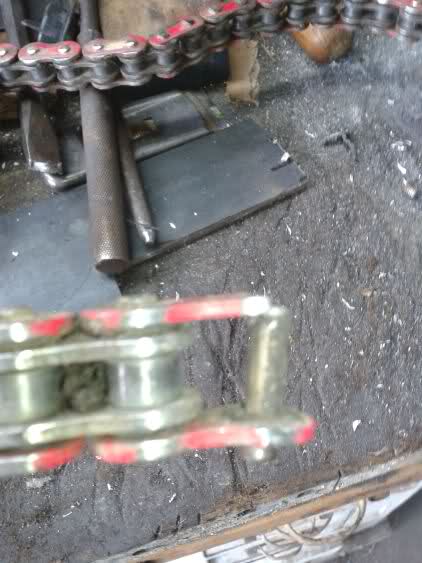

tried to go for a ride today, finally got my son to get free from work and the va-jj vaccuum he's been in lately, LOL,
and my neighbor matt in the rhino660
I didn't make it 20 yards into the woods when i goosed it,
and the KOR power I:I did this..........
snapped :o
this was not the master link, it is still intact, this was a Factory Spec brand, 520 o-ring banshee chain, with 8200 lb. tensile strength, on very good condition sprockets, with about 4 rides on it, i still hadn't even needed to re-tighten it yet ?
prolly good i run a case saver, as i can see where it smacked it good.
i'm not convinced this new found carnage had anything to do with it ???
as i see no abnormal wear on the rear sprocket...
:o:o:o:o
i'll be placing a call to RAD MFG. first thing monday morning.

nope, threw the chain clear, and barely even rev'd, as i noticed the loss of power immedieatly and left off the throttle
My Blaster broke a chain exactly as yours did, not at the master link, one link side failed, shortly after I dropped the 250 into it.

Chain was DID "O"ring I believe, but was rusty as I received it, and had stiff spots in it.
Alignment is always a worry with a swap, and could be an issue with your carrier problem.

unfortunetly i did not buy this directly from RAD, but fortunetly i only paid $50 used, and not $199 retail, then get stiffed on any, if at all, warranty
i will still be seeing what they have to say about this
as far as i can see, the 2 thick mounting tabs, that were supposed to hold the actual bearing carrier into place, are just press fit onto the tube, it is funny (triangular/oblonged) shaped to prevent rotation of the tube in the tabs
then the cross tubes are welded to each plate to lock it all together,
there is zero welds from those 2 thick plates onto the bearing tube at all, and that is where the fault lies in these carriers
as soon as any wear occurs, it must quickly multiply, wearing those aluminum tabs until you see what happens above in the vid

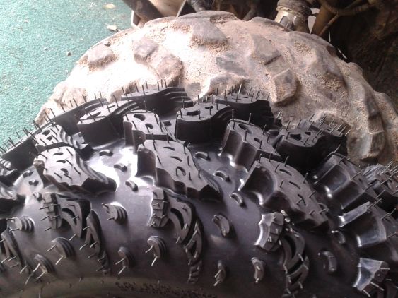

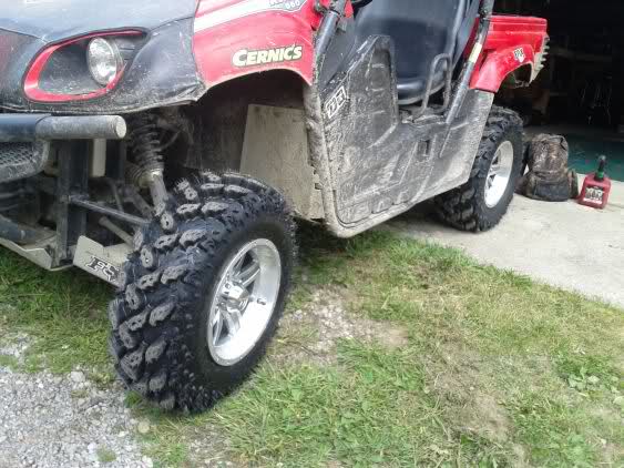

ordered these tires for my buddy matt,
pretty nasty tire ....Interco Reptiles, got all 4 for $378
w/ free shipping from traxx motorsports
took him this morning to get the "new shoes" put on,
I know the owner of the tire shop, he wasn't there so I had to "sweet talk" his 400lb. daughter, LOL,
but got all 4 tires swapped on with new valve stems for only $20
and of course we had to take it out for a test spin......
old vs, new...........
