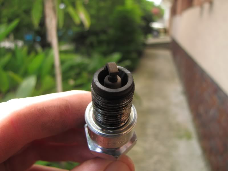

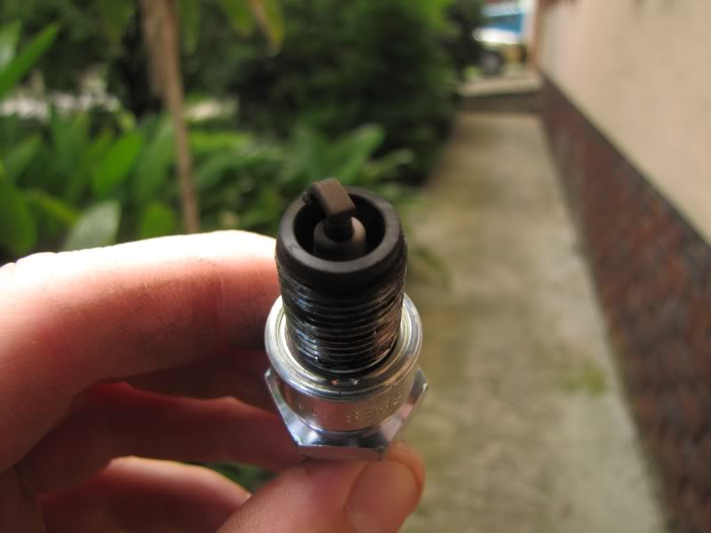

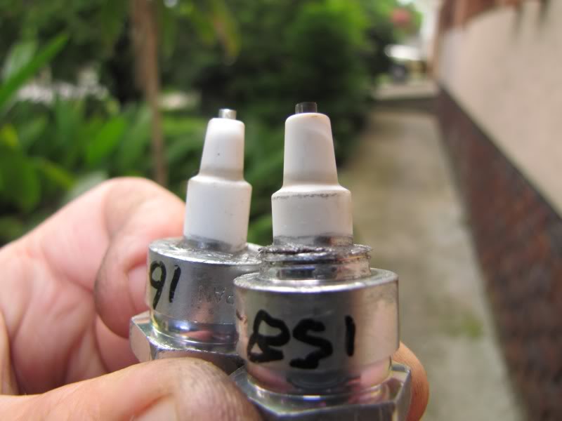

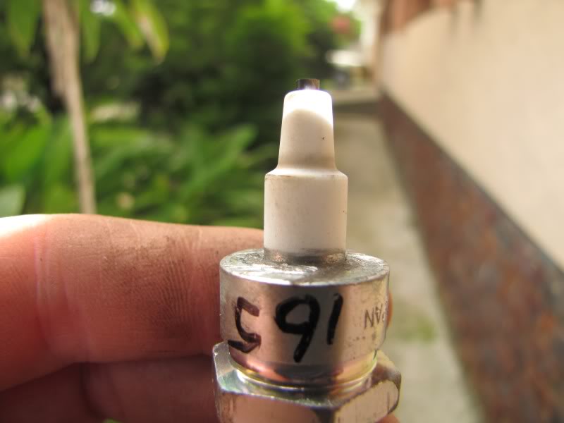

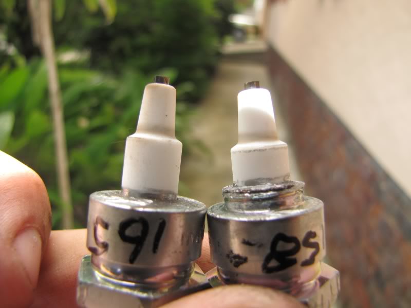

The 1st rwo pics show the 165 on the left and the 158 on the right

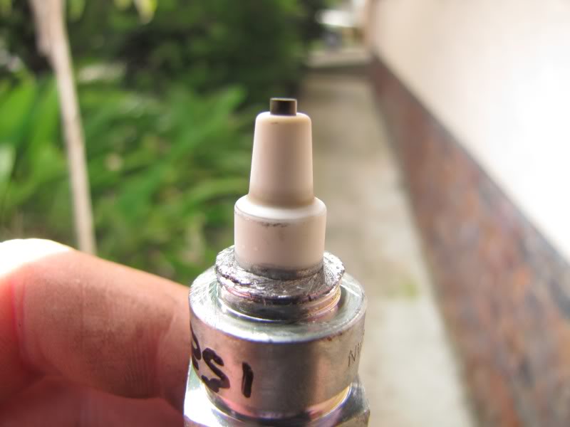

this shows the 165

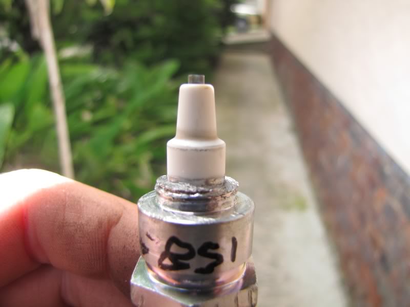

these two show the 158
the pics dont show what you can see in real life though, the 165 is definatly darker (only just) with the eye. the 158 is lighter
power feels good with either the 158, 162 and 165. highest top speed was attained with the 158, 1.6km/h faster than the top speed with the 165.

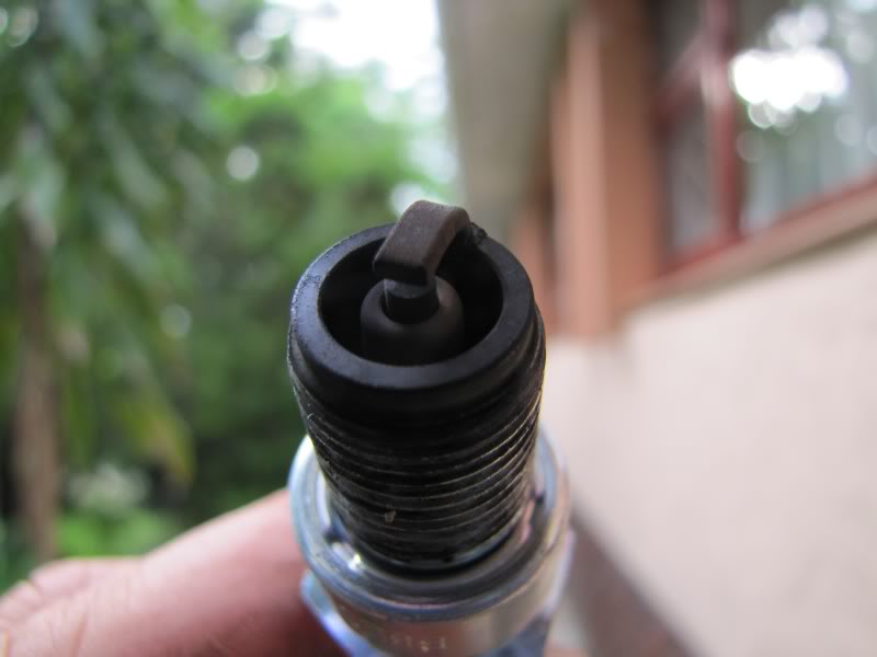

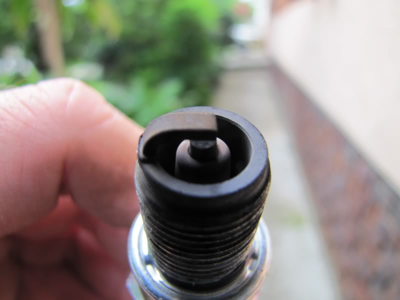

here is the 165 after running a little, (i didnt cut it as it was my last one)
any thoughts??
