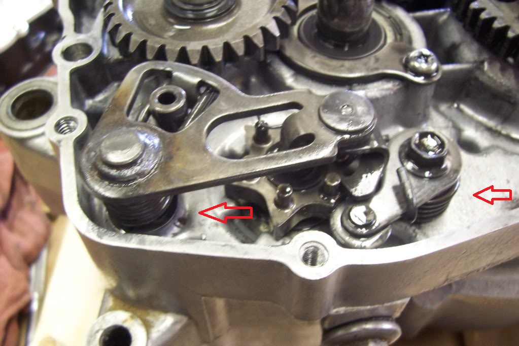

Ok. The shift shaft is ok, the star was loose but got it tightened but I'm having more trouble. I put my shifter on to make sure it was ok before I put it together and it's springing back like it should now but I could only get it in first and neutral, than I kept messing with it and I could get first neutral second and third but no more..... I kept playing with it but now I can only get first and neutral again and I cant get the star to spin any further..... Any tips would be great, thanks guys. :-/
when my bike is parked i cannot go up through the gears without rocking the bike forward then up 1 and rock it again and up another, try turning the sprocket before you put it up a gear?
how did these springs look?
Yeah, they're almost impossible to shift without one or both shafts moving. And if the clutch is installed you'll have a bugger turning the motor also.
Slngr, they look good and ok I tried spinning the sprocket shaft while changing gears, it makes since but I'd hate to put it all together and still have an issue. Lol thank you guys so much! I:I
