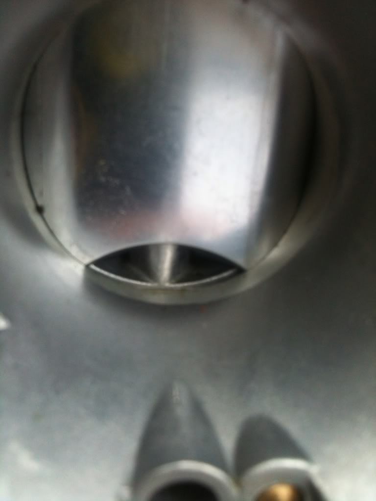

My problem is on a 95 blaster with a vito's 240 kit and a keihin pwk carb.
Couple of weeks ago I noticed the bike would start to rev higher and higher as you sat in neutral after riding.... Well one day I take it for a quick spin, shut it off, and when i start it off, it would run like crap, so I put it away and figured I would try it the next day.
So the next day I start it up, revved super high with choke on but stalled with choke off... took it for a spin and the throttle would stay open after i let it go and then bog down slowly.
I cleaned the carb, checked compression(150) and started it back up, revved to the moon as soon as you start it.
I disconnected BOTH end of the throttle cable, kicked her over, and she purred like a kitten with choke on and off, but I noticed the cable seemed fine and was sliding as it should, so i shot some white lith grease down her and hooked her back up... SAME EXACT THING!!! revved to the moon as soon as you start her.
as you can see the throttle plate is all the way down to the stop... any answers? The cable really did seem to work as intended, could it be anything else?
