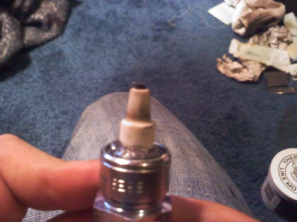

here is a old plug of mine it ran very well tad on the rich side but i liked it like that wasnt realy any sort of bog or anytthing but i dont see whats wrong with runing a little bit rich on a trail bike as long as its not boging or anything like that remeber your mototr will last longer a little bit on the rich side but heres the picture
its a nice chochlate cardborad brown sorta color like 99lrd's are between these pictures you should get a good idea of how they should look
haha it's such a biotch to get a camera to focus on a spark plug isn't it? X( :D
