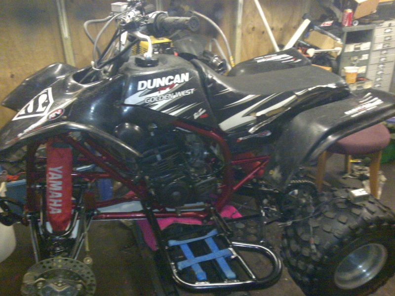

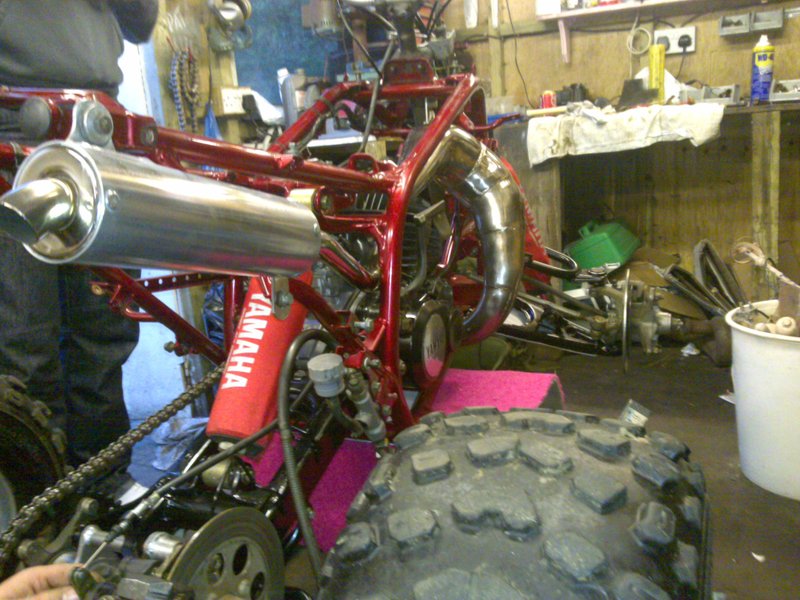

A few pictures of my brothers 2005? 06? blaster with his custom fab, skid plates
Shug Tech

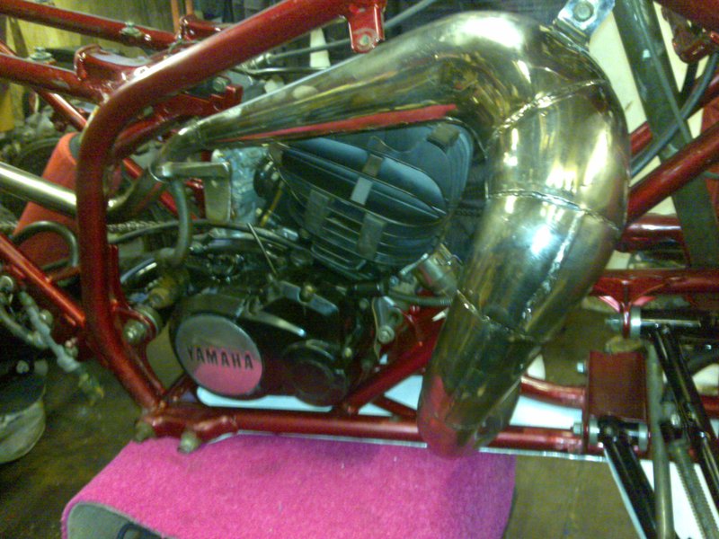

Also a few pictures of how the build was going on..

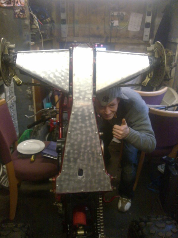

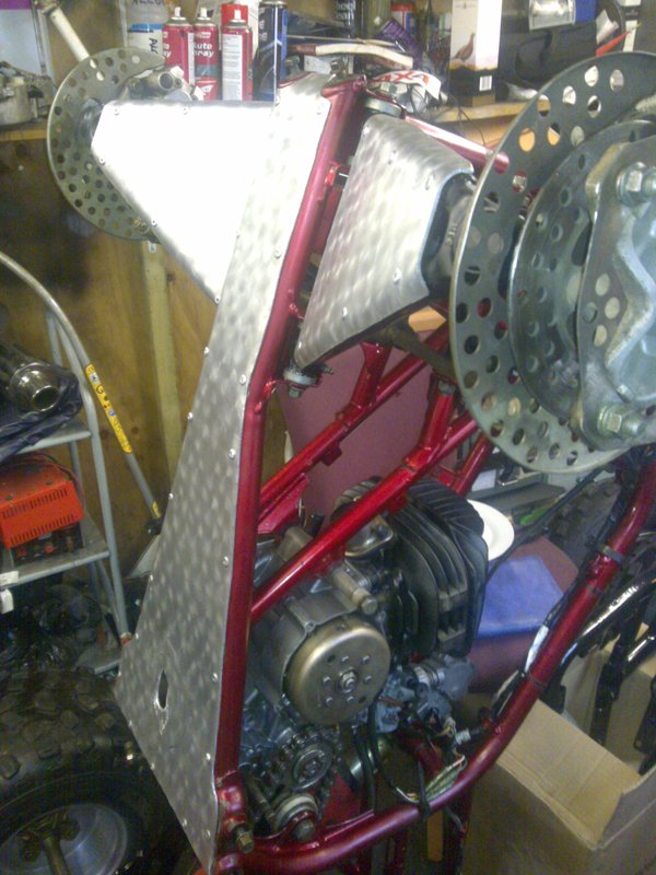

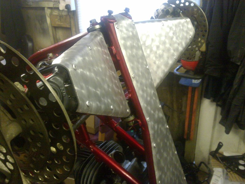

the skid plates were made from a road marker sign :)
with a template marked out in cardboard and used to get the overall size and shape, then cut to fit, then using a rivet gun to secure it to the frame...
the swirls on the plate, were made using a small scouring pad in a twist motion to give the circle effect..

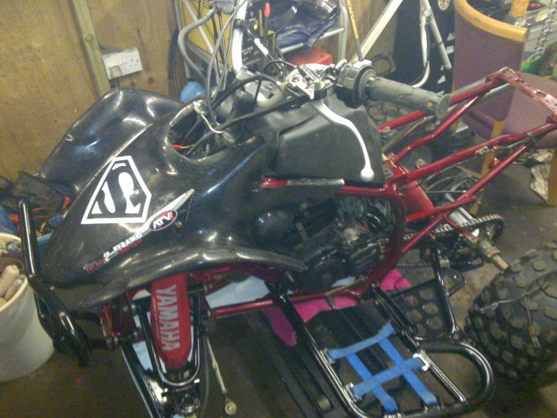

your blaster looks real good i like the color combo but the rivets in the frame probably werent a good idea but it still looks nice good work guys
cool guys dont mean to b cheeky but yous mob a (steamin drunk )its not got a ferrari 430 engine in it ,and shugtechs the man ....shugtech is god reincarnated ...wot he says goes so put a sock in it hes all ready built yz 250 blaster a stroked balster and a hole lot more this project was built for a laugh to our quads look sh*t and he done a very good job .wot u think mrthrust..
here,,,,, what is it about the front "hood" that you dont like, is it the superman logo? i thought it looked the biz!!... it'll look even better when im driving about wi my black superman costume on...lol
be better to weld some nuts onto the frame , then bolt the skidplate on , won't weaken the frame , and will be far easier to remove in the future , still looks good , keep it up
