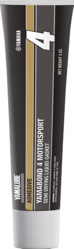

Use Yamabond or Tribond sealer.
Do NOT use RTV or silcone sealer or gasket maker or any other substitute.

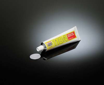

Sorry, "ThreeBond" ia a company name just like "Yamaha" and they sell a pile of products.
Bike shops around here all carry tubes of ThreeBond 1104 and we just refer to it as "Tribond".
Yamabond 4 case sealer at the Yamaha dealership looks like the exact same stuff out of the tube.

What you need to seal the cases has to resist oil and fuel, and be thick enough to fill gaps but thin enough not to extrude.
None of the 1200 series sealers are fuel resistant, neither is the RTV you buy at the hardware store or most silicone products.
TB1104 goes on thin, seals everything, is tenacious and yet cleans off well.
Accept no substitutes!
