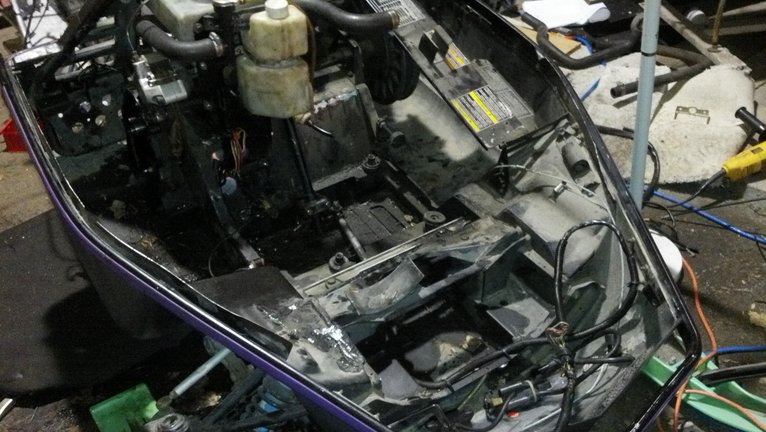

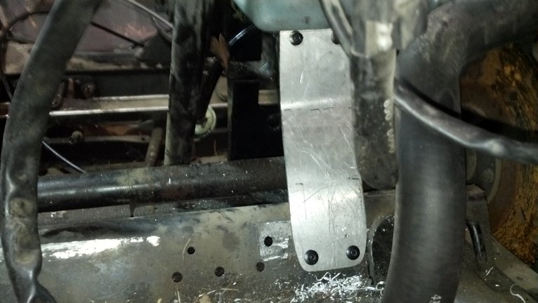

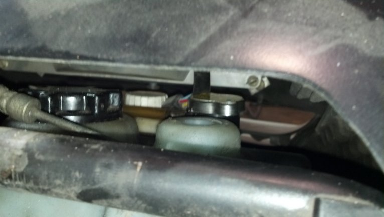

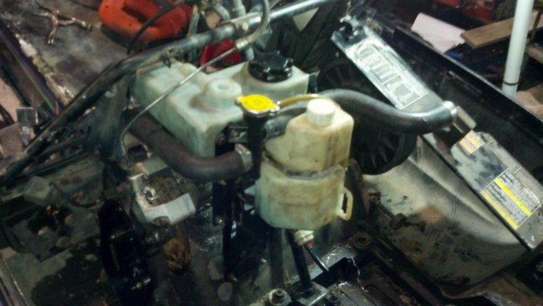

Oil and coolant res tank mount is now bolted in!
Ripped out the old chunk of metal that acted as a splitter or something and put this in as a support. Sucker is solid!
Everything manages to fit under the hood better than I could have hoped for!

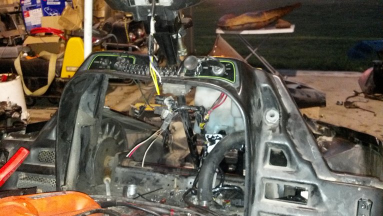

Gonna need to finish up that wiring when I can, then it's on to that engine mount...

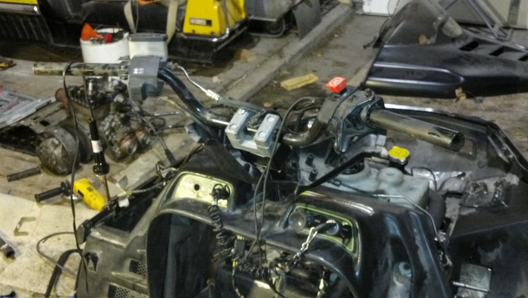

Didnt realize how tired I was until I sat out in the heat for a bit after work XD Managed to break down the brake lever and see that the switch for the brake light is down, so I either need to buy a new one or modify the perch to hold the Mach 1's switch, leaning towards getting a new one. Got the Hi/Low beam switch soldered up and verified function, also pulled the throttle lever and kill switch assembly off the Mach 1's bars and put them on the 440's bars. Still got a bit of work to do, will crack on some more of it tomorrow!

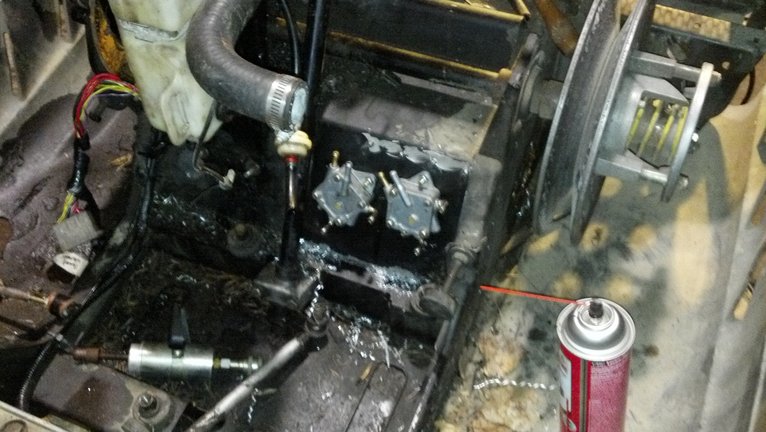

Got a decent amount of progress tonight!

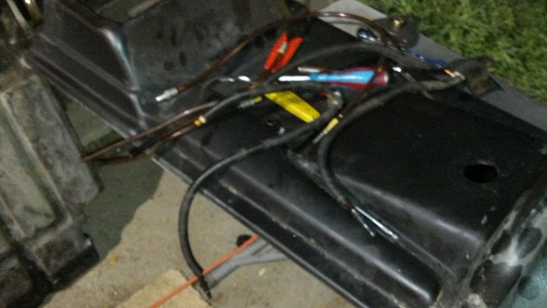

Fuel pumps are in!
Also got a start on the tank, holes are drilled to mount the fuel level and for the 2 new lines coming from the tank to feed the pumps. Also was able to use the cap from the Mach 1's tank, muahahaha! No more floats to fall into the tank! LOL

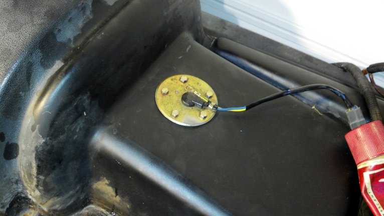

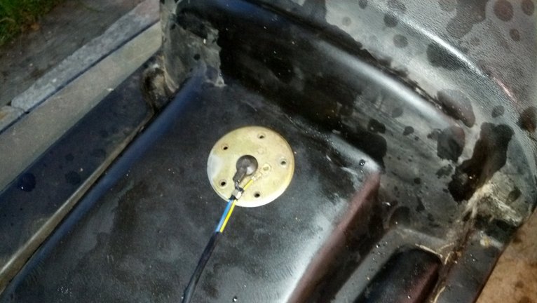

Got the fuel level mounted in there! Made a plate out of 1/8" aluminum and threaded it then epoxied it into the tank itself to give the screws something to bite in to.
Got some water in the tank today, so far no leaks! Tank level also works as it should! Going to apply a little pressure to it when i get off work and see if I can force any leaks to show up that are there.

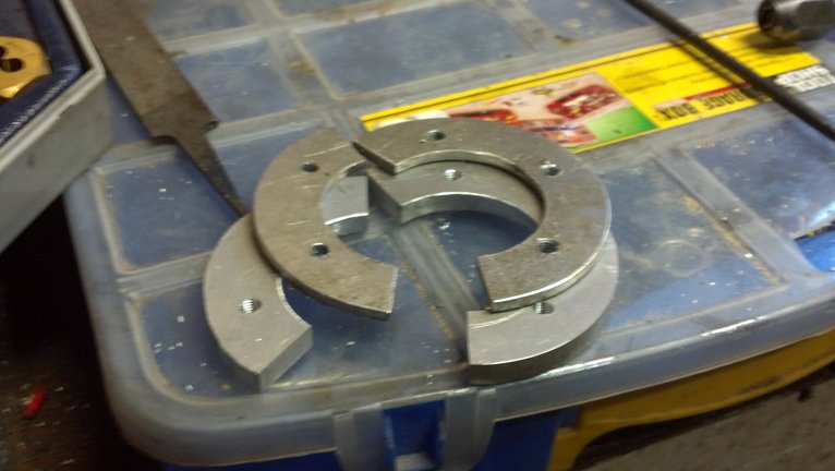

Had a leak at the level gauge -.- so im gonna need to break out the silicone! Also remade the plates out of 1/4" aluminum so the screws have a bit more thread to play with. Instead of epoxying them in I will use some of the countersunk 4mm screws I have and bolt them in place:

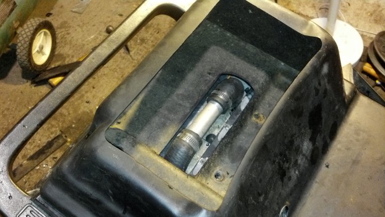

Got a little bit of progress done tonight, trimmed out the seat to get the coolant hose to fit and drilled a hole to pass the fuel level connector into the back compartment. Need to make a shroud to seal off that compartment and extend the electrical to reach back there. Also should be good to go in getting the seat mount done now.

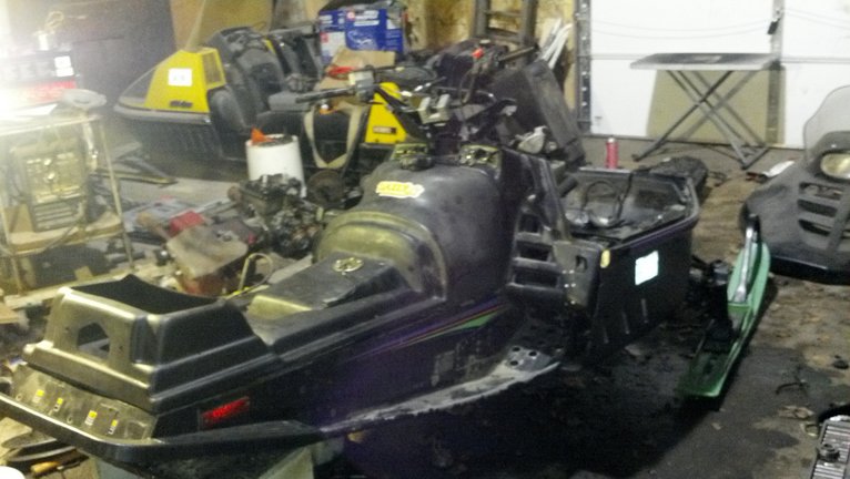

As it sits:

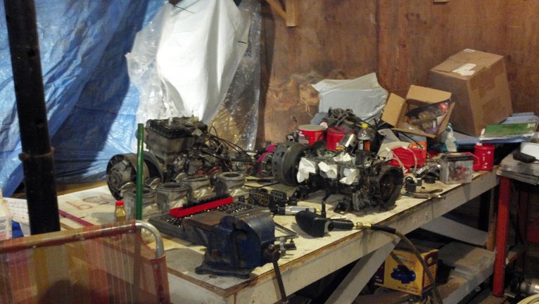

Here's the work bench for now :P
