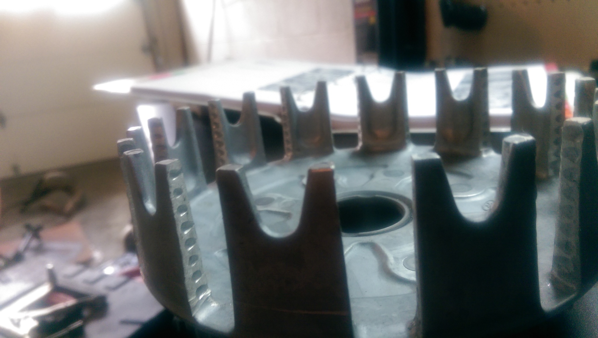

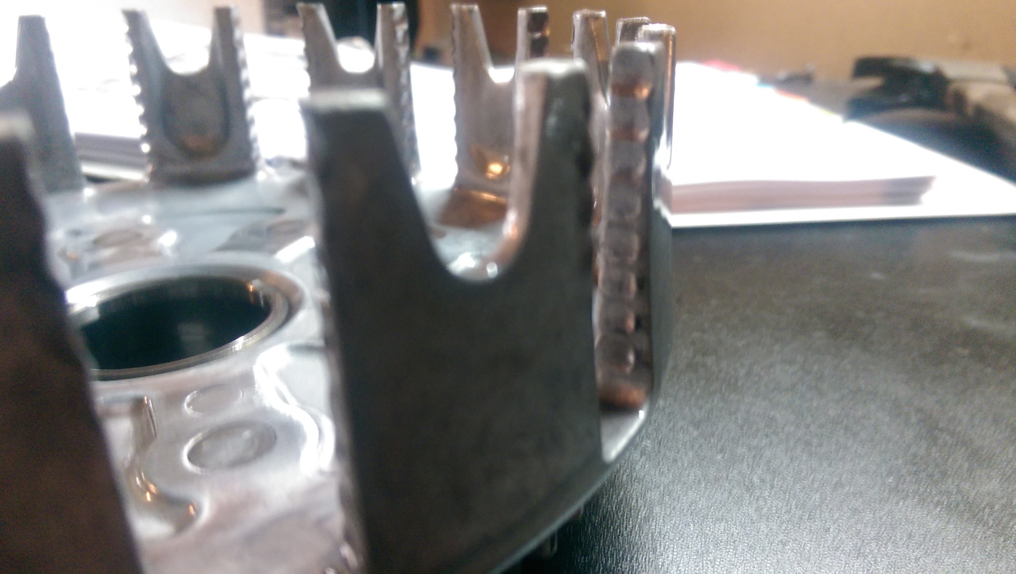

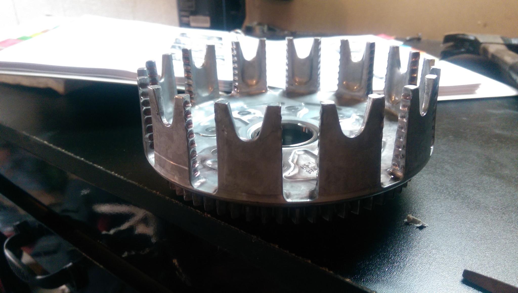

the basket looks like the one i filed. pull the basket, file the grooved fingers. they dont need to be perfect, but it will help. smooth is what your after. like i said, its a one time repair. because if you file them again, you open the width up causing to much slop. .
I'll try that and see where it takes me. Do you happen to know how to stagger the clutch plates so that the transmission runs smoothly? You said you've had a few of these apart.
That basket does look very grooved and lots of play.
Filing it may solve the problem but it may soon happen again as there is a lot of wear.

use a sharp flat fine file. take the basket out the bike. if did't plan to, just making sure.
glad you don't have a dremel, you do not want to use it. it needs to be done with a flat file and some finesse. that way you don't cup the fingers. that would be bad. nice straight, even cuts with the file.
Well, took it for a little quick ride around the block. When I put it into gear from neutral it didn't slam into gear like it has been. Seems like it fixed the problem but I won't really know until I go for a longer ride.
