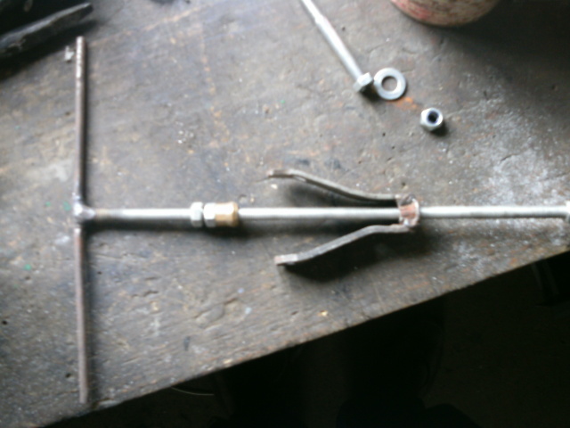

Here's my home made wrist pin remover/installer tool:
Made it for when i rebuilt my XT350 but will work with any piston realy
just have to bend the tabs on the right to adjust to the size of the piston then hold the T and tighten the bolt and it will push it out
you can do it with a large socket also
