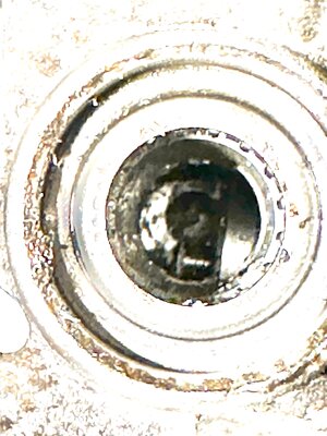

Sorry to resurrect an old thread but this push rod is severely mushroomed......any idea how to get it out? We just finished rebuilding this whole thing and we didnt looked at this until the very end.
