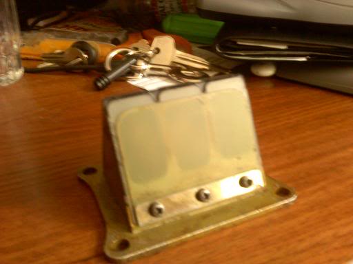

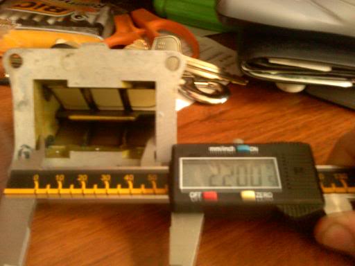

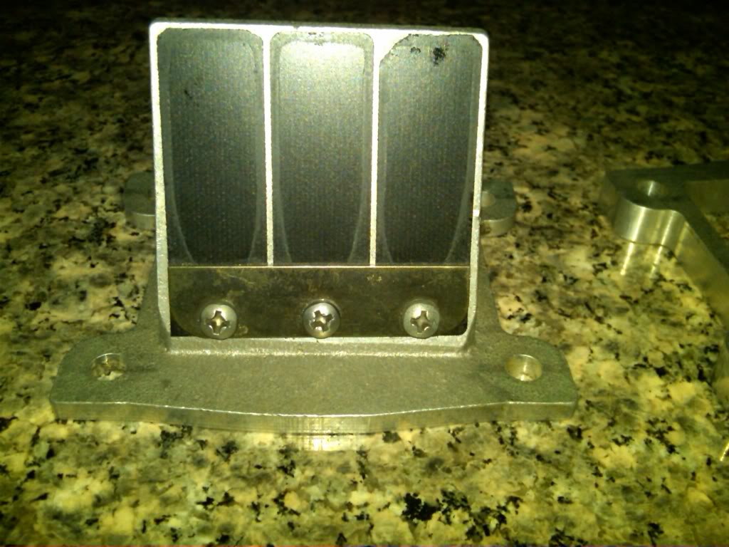

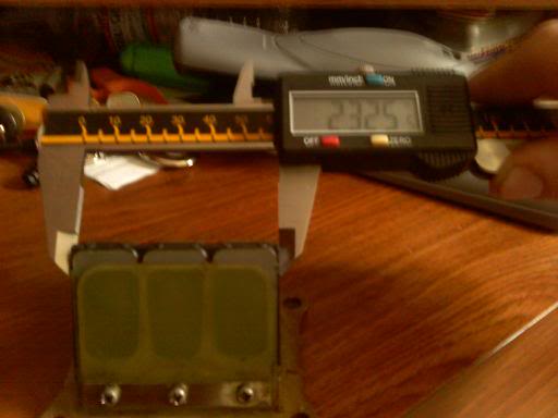

I got some pics of the stock and ct reed cage, so everyone can see the difference.......:)

that has to be a major choking point in our motors, and the cr style cage has to be worth huge gains in itself !!!!!
have a few reps bro for enlightening us with this
yeah, the LA/CT kit uses the bigger CR250 reed cage
It uses a TRX 250R reed cage. But the 1978- 87 CR250R Boyesen power reeds have the same part number. Right now i have 250R Delta V3 in it, and all the CR250 Delta V have a different part number, so i dont know if they will fit....
the cr style cage will not fit a stock blaster cylinder, way too big and uses 6 bolts not 4 like ours, thats one of the differences of the ct/la sleeve cylinder
THREAD REVIVED: what if one was to weld 2 more mounting point tapped to tale the extra bolts? is the 250 cage too wide? i thought i remember someone doing this a while ago?
