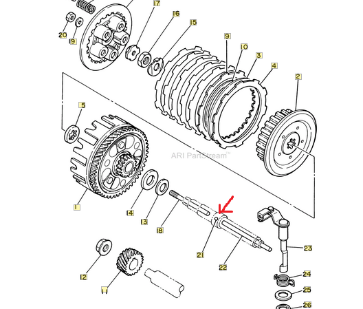

Hey guys. I am new here and this was my first time ever tackling the lower part of an engine. Been around motors for long while, but never ventured this deep.
Long story short, took the entire bottem end part and cracked the cases to get to a bad main bearing. Replaced both main bearings and seals and put it all back together.
Now after getting engine all in machine and ready to put on head, i realized that the cluch does nothing now. Everything spins free in neutral and then when put in gear obviously does not spin.
BUT when i pull in the clutch lever it does not release in the cases anymore at all. I tried to play with the clutch cable but absolutely nothing. Is there anyway to take out the clutch lever that goes into the cases and adjust anything or is it something i didn't attach back when i put the cases bacK?
Thanks very much guys.
