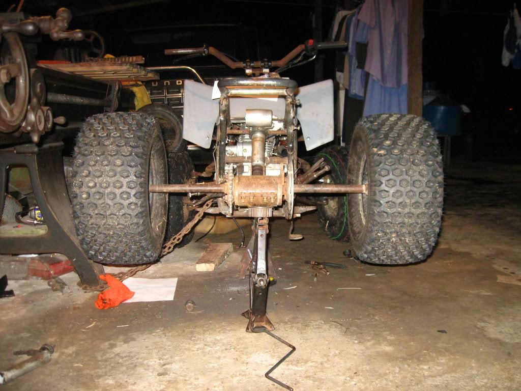

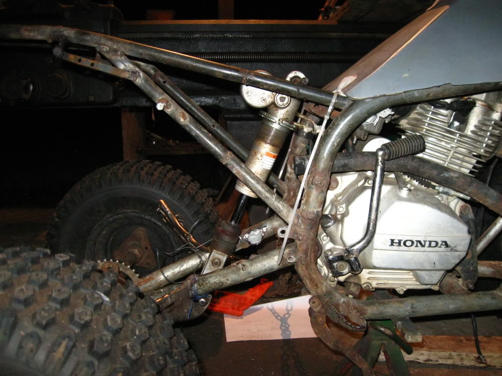

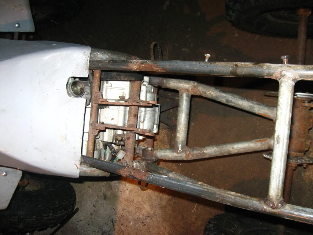

I have never been able to set up a satisfactory rear suspension. I finally got a KFX400 shock off E bay,which looks so heavy duty it almost seems like overkill. Anyhow, to get on with my problem here are some pics
I was thinking of setting up a YFZ style linkage, because I'm pretty sure this quad is too light to run it without a linkage, besides that it was built for a linked suspension.
However, I am wondering if there is a way that I can mount it without a linkage.
I just need Ideas as to what would be the best way to mount it.
I will obviously need to move the crossbrace on the swinger,I also think the swinger is too short (16in) :o
I would greatly appreciate any pointers anyone could give me.

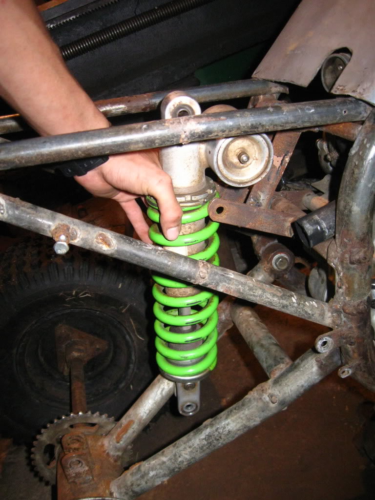

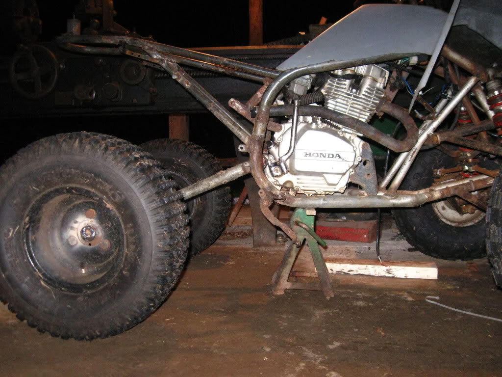

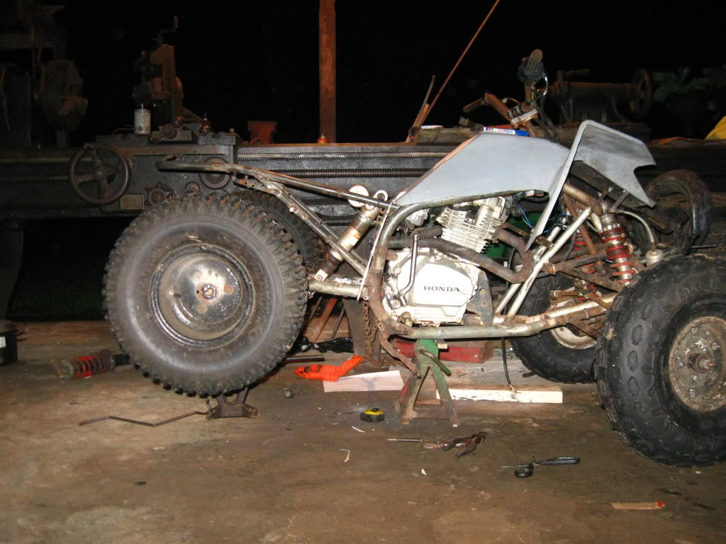

Here are some pics of what I have mocked up
The way I set it up tonight (wire and Vise-Grips) I can get right around 8inches of travel. I can't get away with much more than that anyway as the frame is only 10inches off the ground, so I'm ok on that point. My main worry is that the ride will be too choppy, this shock is pretty big and the quad is kinda small. I was originally thinking of a linkage setup, but I want to avoid that if at all possible.
What do you guys think? Or should I mount it this way, and try it, and throw on 2-3 inches more on the swinger length? It's only 16inches long right now, that's on the short side right?
