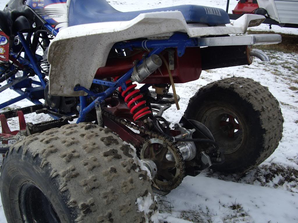

DUALSTROKE Giving away free clues Technician Mar 2, 2008 5,263 427 134 masshole Jan 30, 2010 #4 I used heavy duty tie wraps and placed tubing around them so I wouldn't mark up the powder coating.They have held up fine.

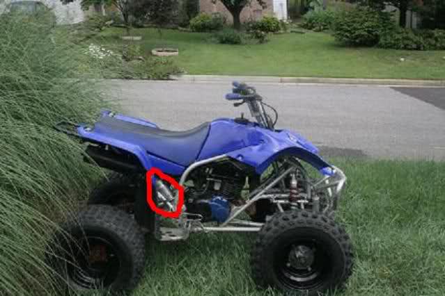

blaster01 New Member Jan 17, 2009 3,575 37 0 Virginia Feb 3, 2010 #10 here is were i mounted my 250r rear shock rezzie Reactions: tyler1blaster

blaster01 New Member Jan 17, 2009 3,575 37 0 Virginia Feb 3, 2010 #12 thanks man......that was the only place that my shock hose to rezzie would reach to and still be able to adjust it.....and i was worried about it geting hot being beside the pipe like that but it wasnt bad

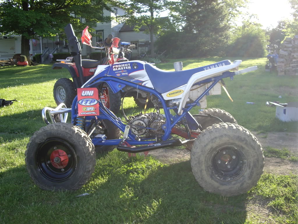

jfblasterboy65 Member May 14, 2007 732 12 54 Westtown, NY Feb 4, 2010 #13 this is a pic of where i mounted the ressi on my 250r shock i used to have u can barely see it and it was super easy to adjust in this spot below my winderosa sticker it is
lasxgames Member Feb 4, 2009 2,346 45 53 Minnesota www.hookit.com Feb 4, 2010 #14 just keep it away from the pipe so the shock oil doesn't heat up
