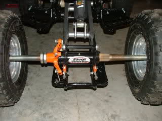

this is what I did, kinda like xjma was talking about
You can see the grease zerk in the middle
Hey guys! That grease zerk is a great idea!
