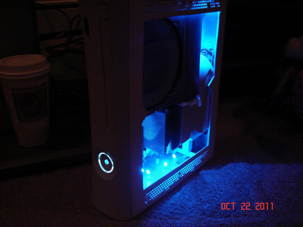

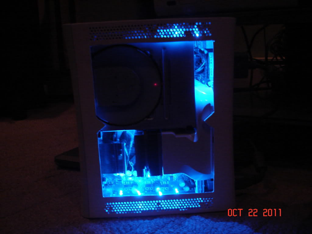

My most recent project, swapped the console Ring of Light LED's, blue center LED, and 4 White Player Led's, then added 7 3mm Blue LED's to the console, cut open disc drive, as well as a cut shell window. I used the 12Volt Power Source from the Disc Drive cable, the bottom right wire is the power, just cut off some wire sheething and soldered a new wire to it, then used 220 Ohm Resistors for each LED. Just need some plexiglass and this thing will be for sale! Works GREAT!
