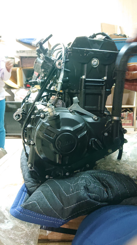

OK, so today i received my Yamaha r3 engine. its so nice :)

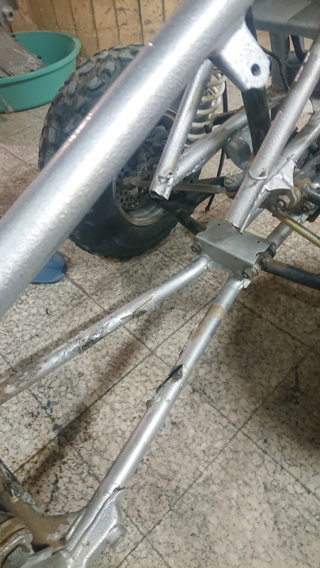

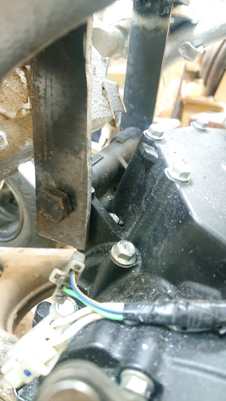

First thing we have to do is remove the two pipes going down from the front to the middle and the bottom supporting thingy? look at the pictures to understand me :)

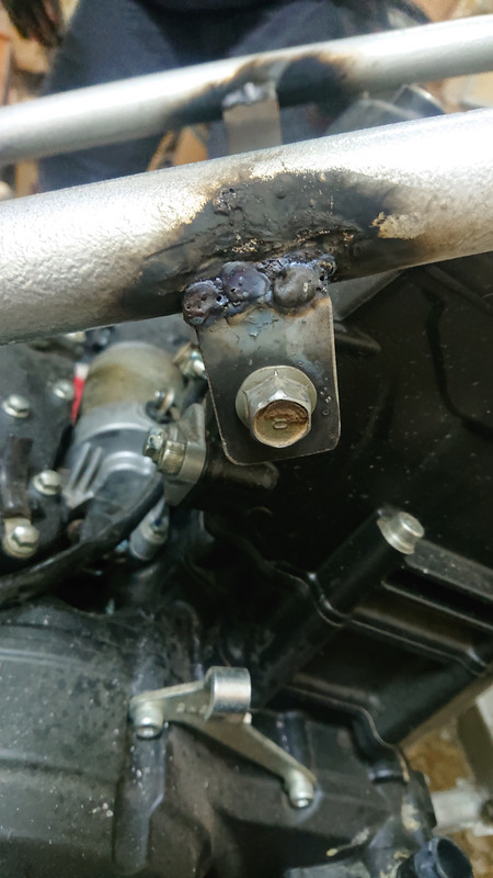

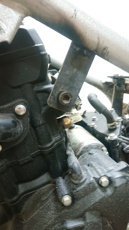

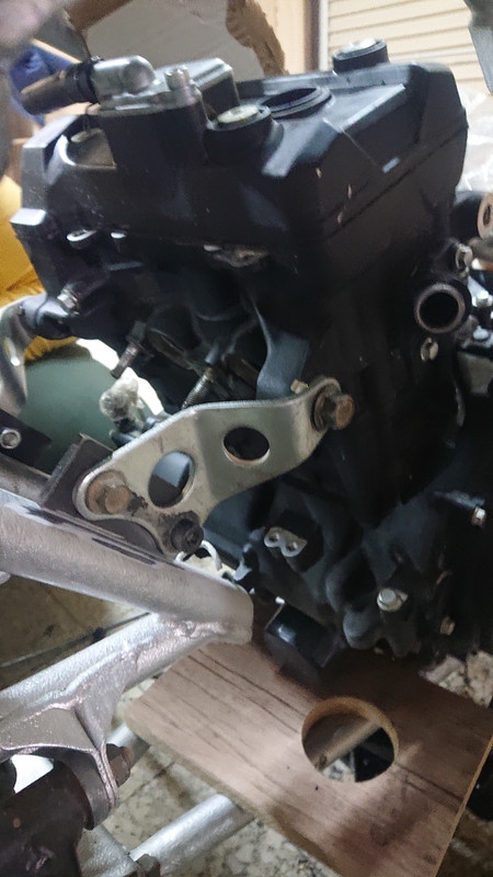

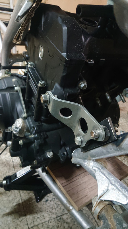

OK, so last night me and my bros :) finished the two front engine mounts. we used a YFZ450 mounts that we had laying around.
we did weld it.

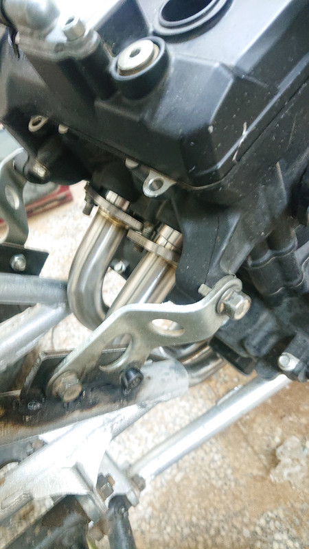

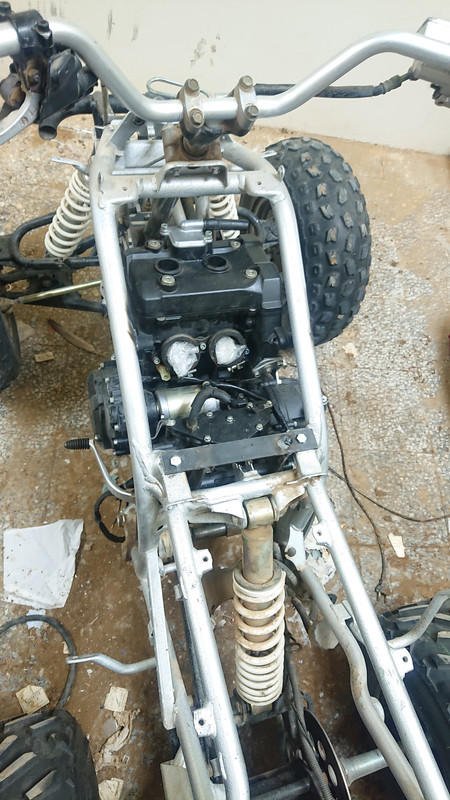

ok so last weekend we got all the engine mounts in place (as seen in the pictures) now we are planning the exhaust and will start fabricating it.

That weld (looked like a night of grinder grit snot rockets building up)..lol.. ive done worse weld than that before tho. Lol..
