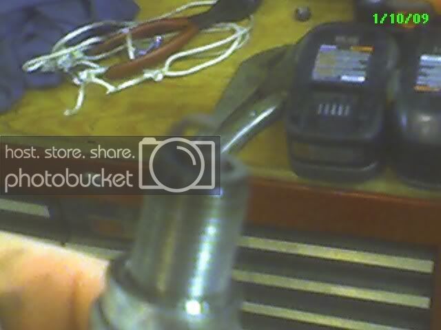

its was the cable sticking..on the TORS.... my plug looks good... its just a little wet and a nice brown color. heres a pic

im guessing that the cold air was making it too lean like the other guys said and id try going down like maybe 5 on the main or a size on the pilot, try messin with the needle a lil too.
