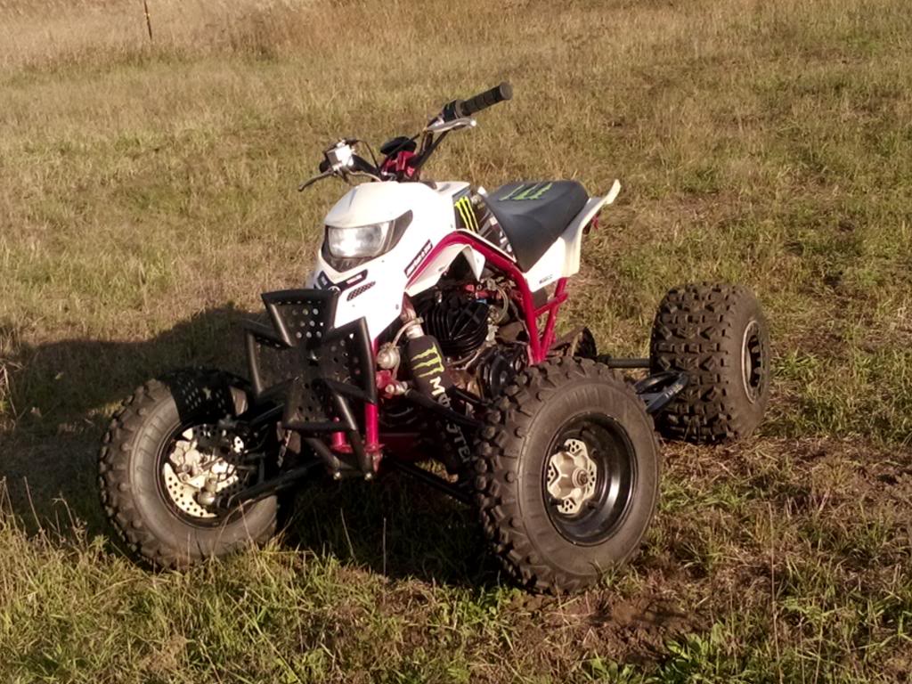

2 heat cycles are done. I bought some of that peel coat stuff to see if I want to Black Out the Blaster. I did the rims, and front bumper.
I'm open to suggestions.
Match the black of the bumper to the flatter/more matte color of the a-arms and it will look good.

The peel coat was still wet in that pic. It actually dried a matte Black. The cool thing with this stuff is you can remove it easily. For $6 it was worth it to see if it looked cool.
I think I'm going to end up doing all of it in black, I like the look.
i have painted all mine black as well.
only thing that sucks is paint does chip off and need to freshen it up once in awhile.
and if you try scrubbing it forget it lol
and do both inner and outer rim:D
I might try and get it all powder coated over the winter
My rear rims are so banged up it isn't funny. I still have a set of stock steel rims I might try to get done.

I got the insides of the rims done and the grab bar. My swing arm's powdercoating is flaking off really bad. I'm going to have to send it out over the winter to get it done right with everything else.
Not a bad experiment for $6 with the peel coat.
