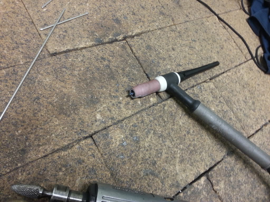

Tig Welding was done with an air cooled torch, i was running at about 180 amps using AC polarity with AC balance set to max cleaning action. Anyways that SOB gets hot as hell compared to a liquid cooled torch LOL
