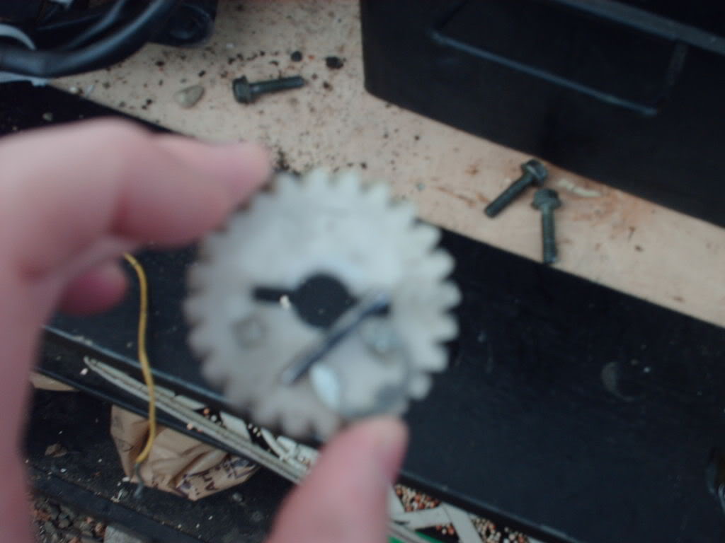

Don't even worry about the pump, just remove the plastic gear.

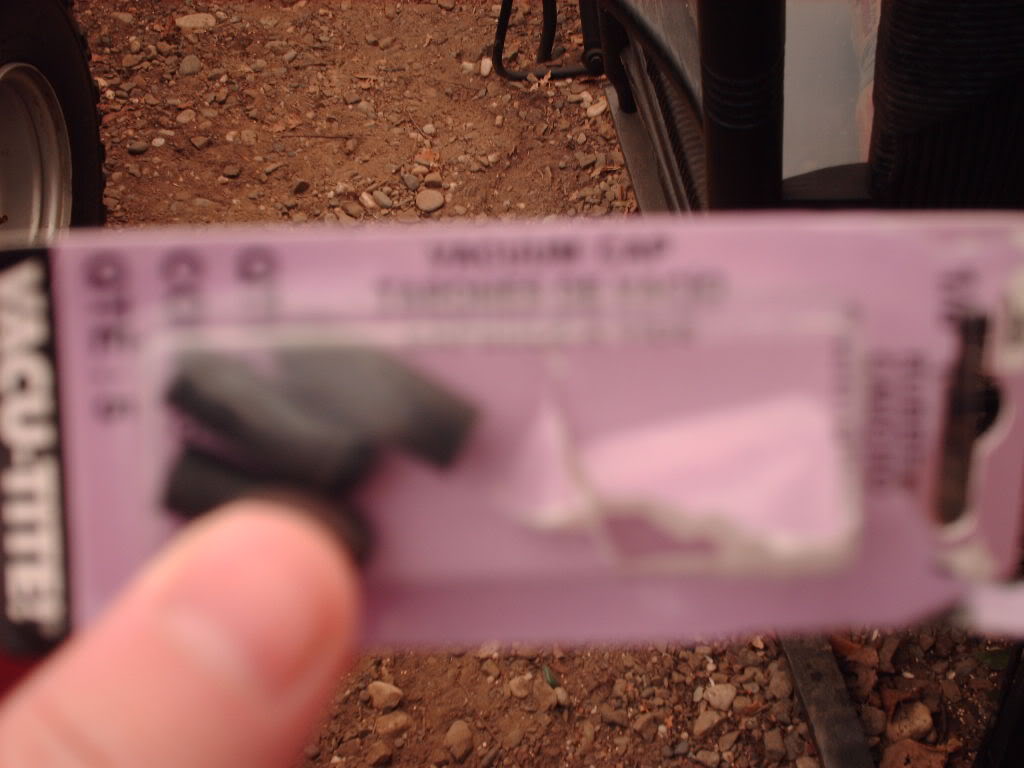

Go to a csk, or auto zone and get the smallest vacumm cap they have I used a 1/8" or 3.17mm
Now remove the kick starter first, you may want to use a braker bar.
once the cover is off the plastic gear will be attached with a circlip and a small bar.
Once its off it should look like this

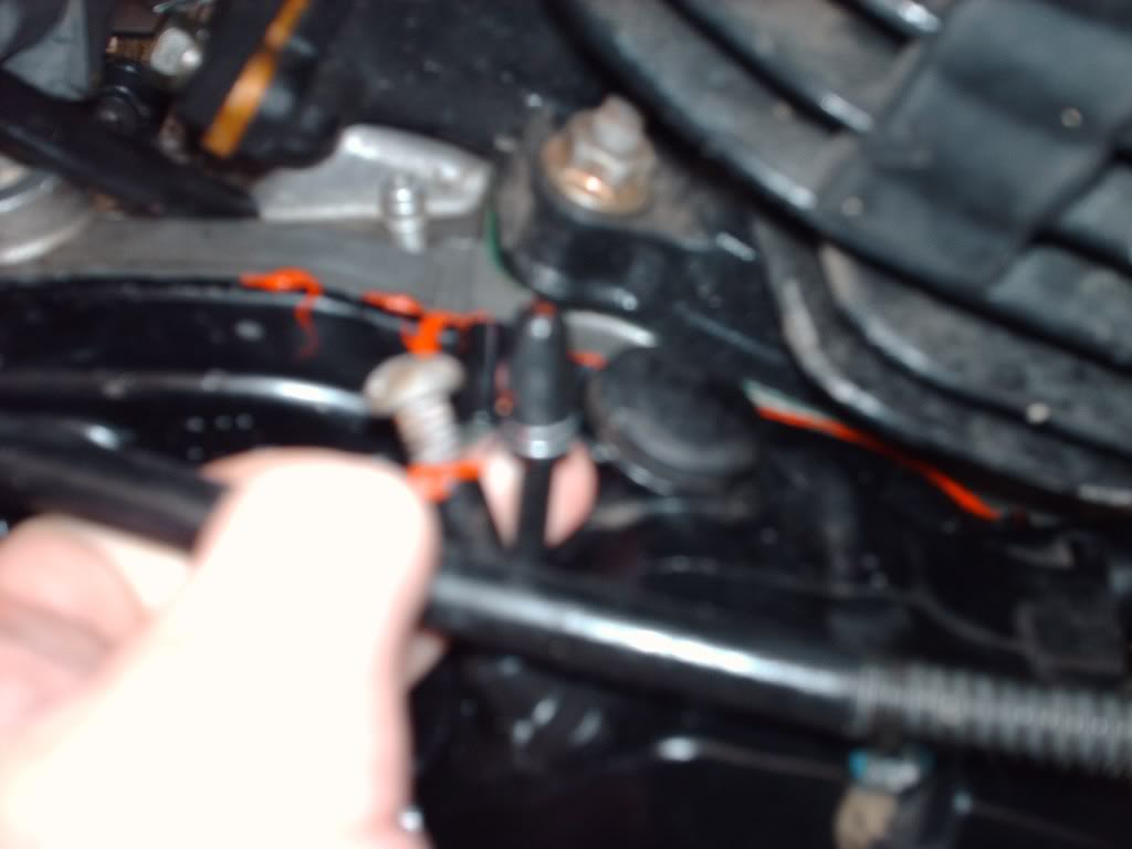

Now cut the oil line that gose to the oil tank to the pump, cut it like 2" away from the pump. now let it drain into a bucket. Now take a screw and plug the line that you just cut. Now cut the oil line that gose from the oil pump the carb, leave about 2". Use your vacumm cap to plug the brass nipple on the carb, and the 2" stubb left on the cover.
It sould look like this.
You dont have to put wire around the vacumm cap but I did for extra safety
Sorry... I know my camera sucks.....
Hoped this helped!I:I
Ok ill try that.. but i need 2 x vacuum caps right? one for carb and one for the pump ? .. and just a screw for the line that before connected the oil tank. . . .
