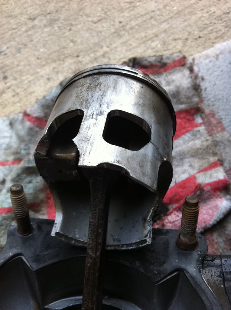

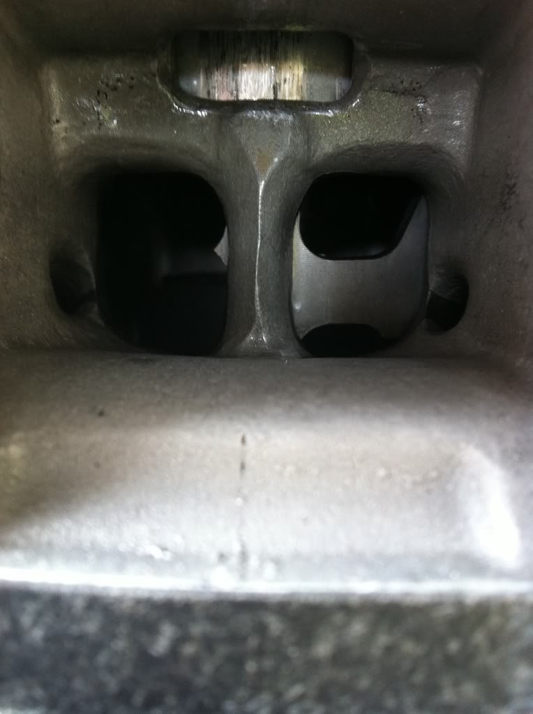

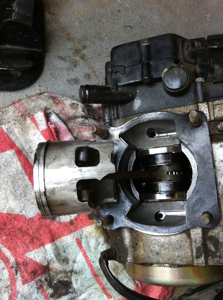

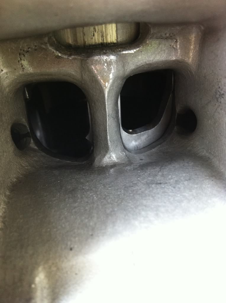

so i was kinda just cruising around the other day, i wasnt riding hard or beating on it and all of a sudden it just sorta bogged out. but since i wasnt supposed to be riding in the area i was at i pusshed it into the woods real quick for a closer inspection. i tried to start it and it kicked over after about 5-6 kicks but then i heard metal clinging-clanging around, i killed the engine and looked at my motor and noticed my exhaust was loose so i hand tightened the olts a best as i could and started it up again (i thought the metal noise was my head pipe vibrating around on top of my head and making tht noise. so it started up and ran like sh*t. i killed the engine and pushed it home! once i figured out it wasnt a carb/jetting problem i looked at my VF3 reeds i just installed last week, of course they were not the problem either... so then i looked into my intake port to find out my piston broke apart. i took the motor apart today and thankfully my sleeve is fine, i checked the bottom of my case and couldnt find any damage or cacks at all. looks like all i need is a new piston & rings. looks like its time to install my +3 crank and fix a few tiny things while the motor is off ;) why would my piston break apart like that though? ive never had this happen to me.... here are some pics i took below
my guess is incorrect cylinder to piston clearence, causing it to slap the bottom of the cylinder on the way up, busting the skirt
it's gonna need a new bore to match the new piston,
not just slap a new piston rings in so it does the exact same thing again
how many hours on this motor ?
what was the compression ?
who bored it for that piston ?

Yes I bought a used top end with head work, it was ported and setup for +3 stroker & port matched... Except I run stock stroke. So I've been waiting to get it for a while now. Looks like now is the perfect time huh? The topend had low hours on it but not exactly sure how many.
not just slap a new piston rings in so it does the exact same thing again?
Sorry if this is a dumb question lol but would adding the correct crankshaft (+3) that it's setup for solve this problem? I'm just confused. This sleeve is great no scratches, cuts, dings, burrs, etc.Why exactly is it that I need to bore it out if I put the correct piston size in it? You've never steered me in the wrong direction before so I trust you, but I just wanna know why? KNOWLEDGE IS POWER...and then there's Yamaha Blaster! Haha
The reason why your piston exploded is possibly that the jug was worn, causing the piston to flog around and destroy itself!
Have you had the new jug measured?.
If so, if it is within specs and has a good amount of crosshatching in it, there should be no problems fittind a new piston and rings.
I personally would have the bore honed so that the new rings have a chance to bed properly!
