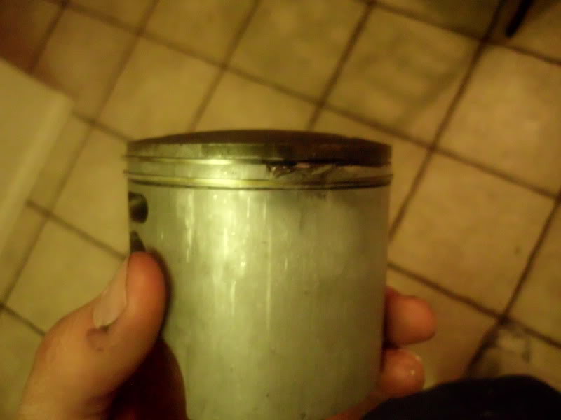

piston is busted, i cant find the piston anywhere HELP!
0_o

it has 8002 stamped and under it it says 72.45mm

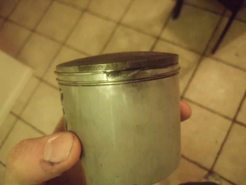

look at how the rings and sandwitched and a piece missing.
what should i do next? take it to get machined and go the next cylinder size?

thats what 30psi of compression looks like!

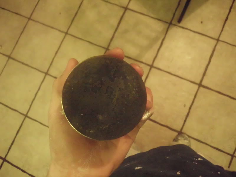

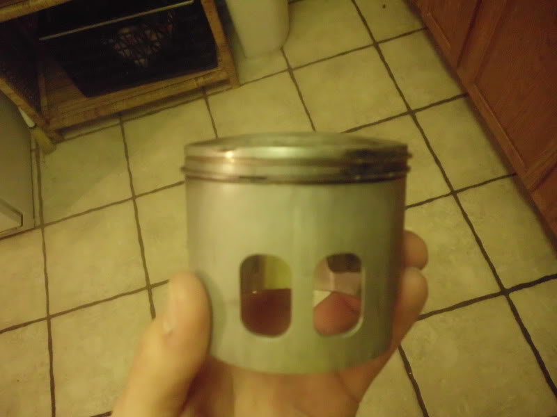

Yeah man.... Bad news with that cylinder. And if you can rotate it in your hand and take a pic of the other side. If it has a cut out on the other side that kind of looks like the helmet to a suit of armor it's a Vito's. lol

Yep, that's what I thought....hole in piston or broken ring.
How bad are the walls in the cylinder.....IE did the ring gouge any part of the cylinder wall badly when it failed? Are there pieces missing? If so they might be in the crankcase and that will need to be addressed. If not, bore to the next size and purchase a Wiseco piston to me that increase in size. After that, just reassemble with a new top end gasket set, tighten everything down to torque specs, do a leakdown test, and be on your way with break in and all is well. I:I
Wiseco doesn't make them in that size anymore. They stopped making the big bore pistons.
Look up the wossner piston in the 73mm. They're the only forged choice left.

And sort of.... You would definitely want to either measure the cylinder yourself and determine the cylinder size or take it to a local machine shop and get them to measure the bore, taper, and out of round. Compare those numbers to the factory specs and see if the cylinder needs boring.
If it does, you can purchase the piston of your choice (either the cast vito's or the forged wossner) and take the piston and cylinder back to the machine shop. They'll bore the cylinder to match the piston so they'll fit perfectly.
You could also contact an engine builder on this site and see about boring your cylinder out. There are several good choices and they'll all do a good job.
Either way, you'll need to determine what you have right now and then go from there.
Namura makes "standard" blaster pistons (66mm through 68.25mm) but his is a Big Bore cylinder. 72mm, 72.25mm, 72.50mm, and 73mm are the available bore sizes. Since you are already on the 72.50mm you may have to step up to the 73mm piston.
