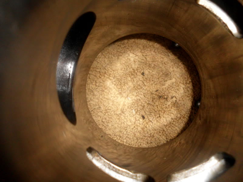

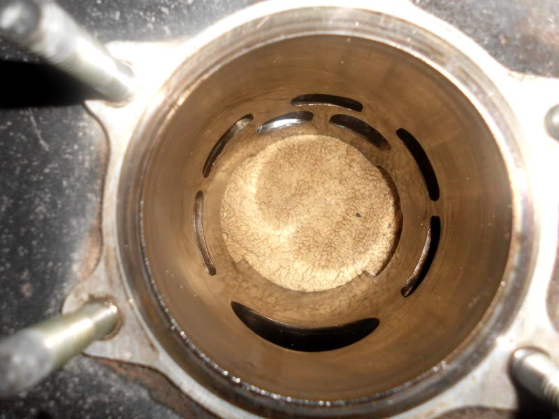

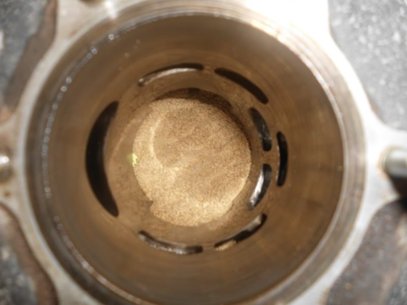

piston is busted, i cant find the piston anywhere HELP!
Factory recommendations on piston to cylinder clearance is .0014"- .0016". Wiseco recommends .0022"
Even that difference isn't enough for me to run a cast piston. When they blow, they just disintegrate.
You should run a compression check immediately after you finish the break-in on a new top end. Then once a month (or if you don't ride your quad that much) twice a year check your compression. Over time it's natural for the rings to scrub themselves and lose their gas tight seal. As they do, it's an indication that your top end needs refreshing.
You can pull the top end off and measure the piston to cylinder clearance and if it's still within a decent spec (it should survive on a single bore several years as long as there is no catastrophic failure) you can hone the cylinder, re-ring the piston and stick it all back together. Do the break-in once again and retest for compression as a "constant" to check future readings against.
Yep, that's what I thought....hole in piston or broken ring.
How bad are the walls in the cylinder.....IE did the ring gouge any part of the cylinder wall badly when it failed? Are there pieces missing? If so they might be in the crankcase and that will need to be addressed. If not, bore to the next size and purchase a Wiseco piston to me that increase in size. After that, just reassemble with a new top end gasket set, tighten everything down to torque specs, do a leakdown test, and be on your way with break in and all is well. I:I

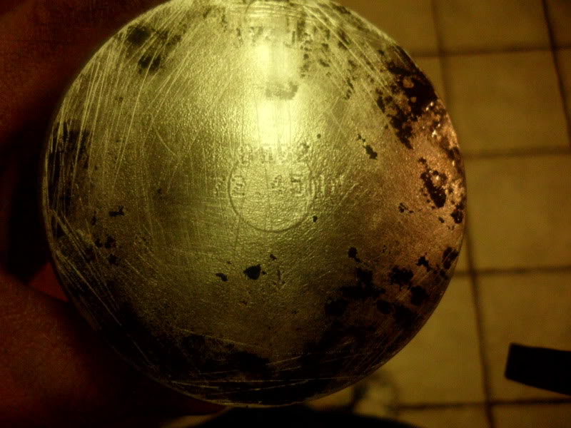

i went to a machine shop today the guy told me i could use the same piston :-/
If the machine shop told you you can re-use that piston with the ring land deformed, you need to run away from that machine shop. His brain is deformed...
You may be able to re-run that same bore (not have to over-bore to 73mm) but you cannot re-use that same piston.

Ok, even 72.45 piston is not anywhere. the link you put is 72mm so the .45 doesnt matter?
A quick lesson about big bore kits. All engines have a specification for the piston to cylinder clearance. For stock yamaha it's ~.0015" or .05mm
Either the piston has to be the stated size and the cylinder has to be slightly larger than that or the cylinder has to be the stated size and the piston slightly smaller.
When Wiseco made big bore kits they decided to make the cylinder the stated size 72mm exactly and then print the exact size of the piston on top of the cylinder. Most manufacturers make the pistons .05mm smaller than their stated size because they don't want to confuse anyone.
Your cylinder should measure exactly 72.5mm (it's already been overbored by .5mm) and the piston will say 72.45mm.
If the machine shop measured the current bore size and said it was ok for re-use, you need to order the 72.5mm piston.
If the shop said it needs to be overbored, you'll need to order the 73mm piston and take the piston to the machine shop to have them bore the cylinder to match the piston.
