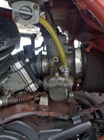

another ? if I may I here that guys or taking the airbox cover off what other engine mods (cheap) LOL can I do to increase Performance! its has stock pipe and silencer/carb air box and filter
also when i purchased this mine my son and I picked up an 96 for him,with FMF Fattie Pipe and differant carb. (IE Lever type Choke/enrichment) with K&N Filter that clamps onto Carb
what everyone else using with bigger carbs and how do you keep water from messing it up?

Placing an air filter directly on the carb throat will need 1 or 2 sizes larger main jet to handle the increased air flow.
If you put a filter directly on the throat if must not be a paper one otherwise gas blow back will destroy it.
Placing a filter directly on the throat of the carb makes a carb harder too tune. Thats why the stock air box (like most) have a bit of a run (venturi) to help straiten out and speed up air flow.
Gordon Jennings teaches that for maxium flow, which produces maxium power the filter should be directly at the carby throat, but you need to jet for it and a stock 26mm is very easy to jet.
Not sure if it,s a stock 26 mm carb or not did the 96,s have lever type choke or did all the years use same stock carb
when warms up againg will do plug check to make sure it,s jetted right
Placing a carb directly on the throat of the carb makes a carb harder too tune. Thats why the stock air box (like most) have a bit of a run (venturi) to help straiten out and speed up air flow.
it has been the experience of many on here, when switching to a pod filter, a 4-6" velocity tube eliminates
the jetting havoc a direct to carb filter causes,
no matter what GJ says in a book.
I totally agree with this Awk.
Gordon Jennings is wise in pretty much all things and has stood the test of time, but I disagree with him here.
Filters directly on the carb have always been hard for me to tune, 2 strokes and 4 strokes.
Moreover, it is impossible to keep pod filters dry in that low location if you are going through any water at all.
I do like an airbox that draws its air in high and forward.

heres a the pic on first post sorry not good with pics lol
My Blaster came with that setup, Triplecrown tried to run it. We found poor results.
I put pods on my KZ1000. Spent over $100 in jets trying to get the jetting right.
Found that at highway speeds I put my hand down by the carbs and vary the power of the engine (mixture).
Even on automobile engines I found better results with a filter housing on than off, even with no filter in it.
Steve
