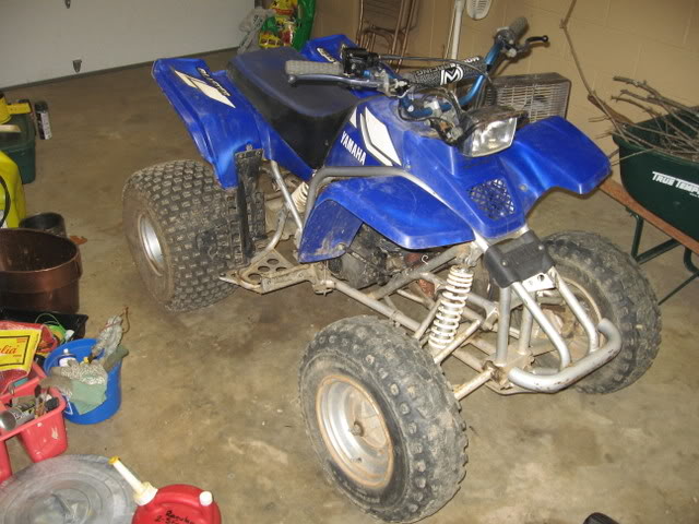

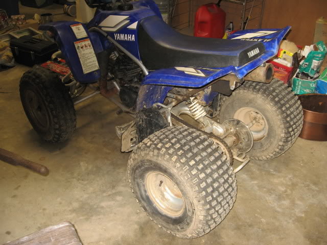

I picked up my 1998 Blaster tonight. Fired right up at the guys house, but now wont idle at all???? I think plug may be fouled out b/c he was running 60:1??
But it ran great 2 days ago on a dead cold start. anyhow, it runs fine, just gotta work to keep it running. it does have a big bore kit. oil injection failed and when the motor was rebuilt, the owner went with the big bore kit, and removed oil injection as well. also, the rear caliper locked up so I only have front brakes since the rear was removed.
