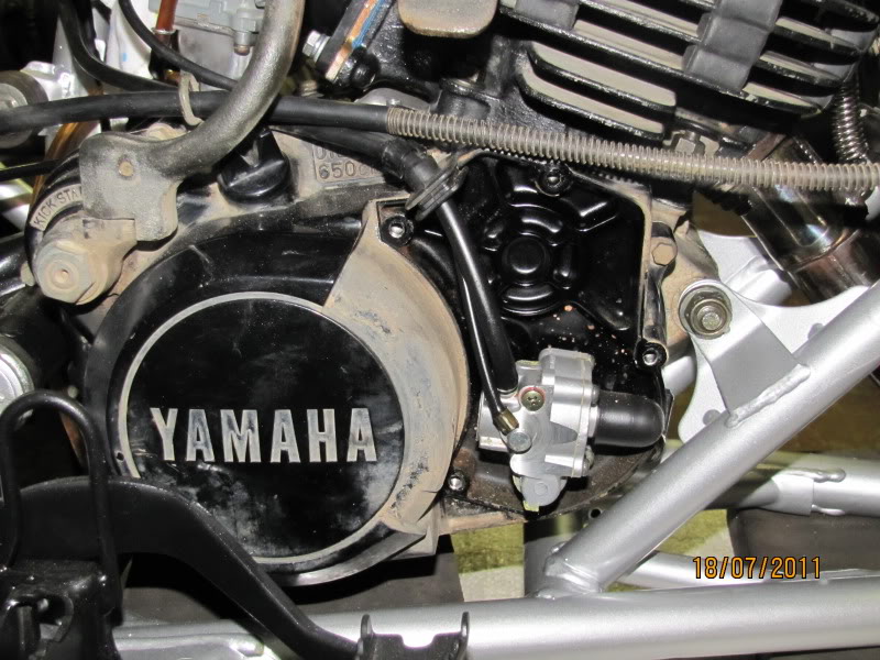

1st, you need to take off the oil pump engine cover! whoohoo!
![IMG_1646.jpg](/proxy.php?image=http%3A%2F%2Fi20.photobucket.com%2Falbums%2Fb246%2Fblaner%2Foil%2520pump%2520priming%2FIMG_1646.jpg&hash=cd5cf05ce7a0d19e54c377ae13ebc728)

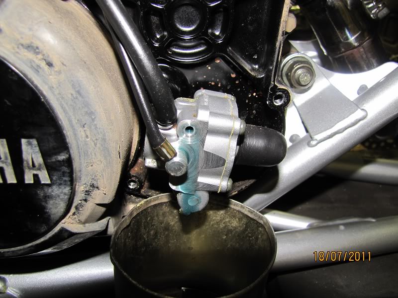

once you do this, remove the screw and washer completely,
![IMG_1651.jpg](/proxy.php?image=http%3A%2F%2Fi20.photobucket.com%2Falbums%2Fb246%2Fblaner%2Foil%2520pump%2520priming%2FIMG_1651.jpg&hash=78dbc1e193c8df41e4a9deaa8534aa40)

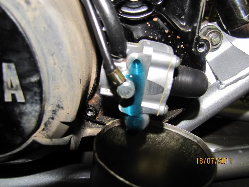

when the screw is out, the oil should run out of the hole, you will notice air bubbles coming out as well, this is what you are trying to get rid of!
![IMG_1648.jpg](/proxy.php?image=http%3A%2F%2Fi20.photobucket.com%2Falbums%2Fb246%2Fblaner%2Foil%2520pump%2520priming%2FIMG_1648.jpg&hash=a302dcad6d80770d6e3121cc1a011af2)
![IMG_1649.jpg](/proxy.php?image=http%3A%2F%2Fi20.photobucket.com%2Falbums%2Fb246%2Fblaner%2Foil%2520pump%2520priming%2FIMG_1649.jpg&hash=cceca47c9db15550a8f5443fee90b2fd)
remember to put a tin or container under the pump the catch the oil else it will mess your floor up!
you may need to kick the motor over by hand a few times to get the bubbles out properly.

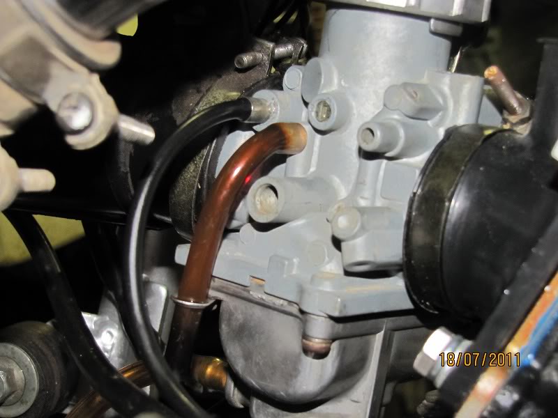

once you are happy that the bubbles are out, you should prime the line running from the pump to the carb, especially if you have had the carb off.
do this by unplugging the tube from the carb..
![IMG_1653.jpg](/proxy.php?image=http%3A%2F%2Fi20.photobucket.com%2Falbums%2Fb246%2Fblaner%2Foil%2520pump%2520priming%2FIMG_1653.jpg&hash=761a356eccf0b0c2a740d9f060e76eca)

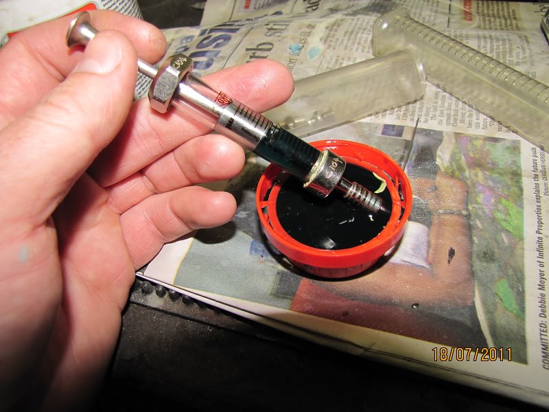

get a nice syringe and fill it up with the 2 stroke oil you are using...
![IMG_1654.jpg](/proxy.php?image=http%3A%2F%2Fi20.photobucket.com%2Falbums%2Fb246%2Fblaner%2Foil%2520pump%2520priming%2FIMG_1654.jpg&hash=407ddb91fb7e5b71dd4f9c8d932b500a)

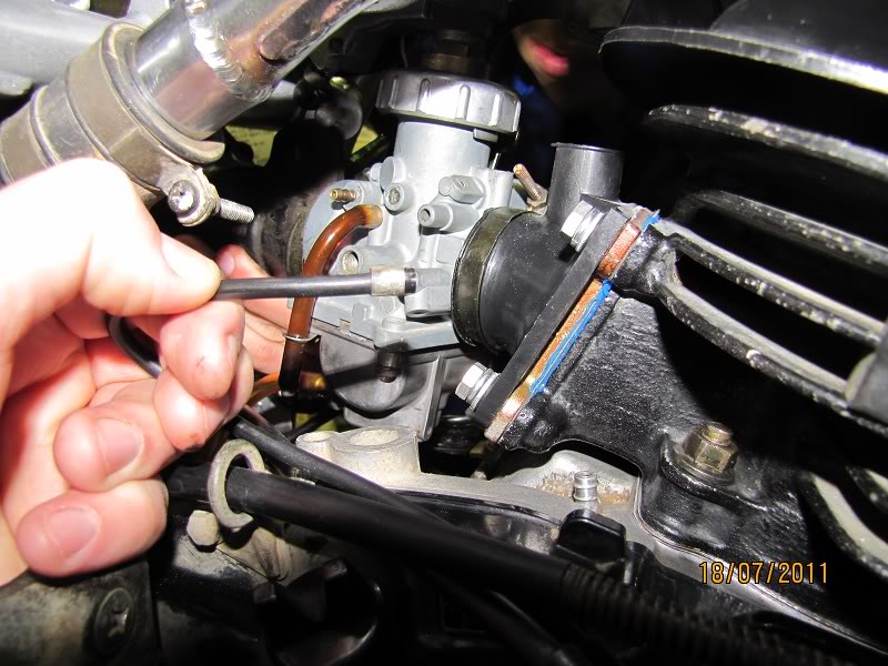

now pump the syringe into the line running from the pump to the carb...
![IMG_1655.jpg](/proxy.php?image=http%3A%2F%2Fi20.photobucket.com%2Falbums%2Fb246%2Fblaner%2Foil%2520pump%2520priming%2FIMG_1655.jpg&hash=c236de7f3ad8a961fa7de34fe9c2d15c)
