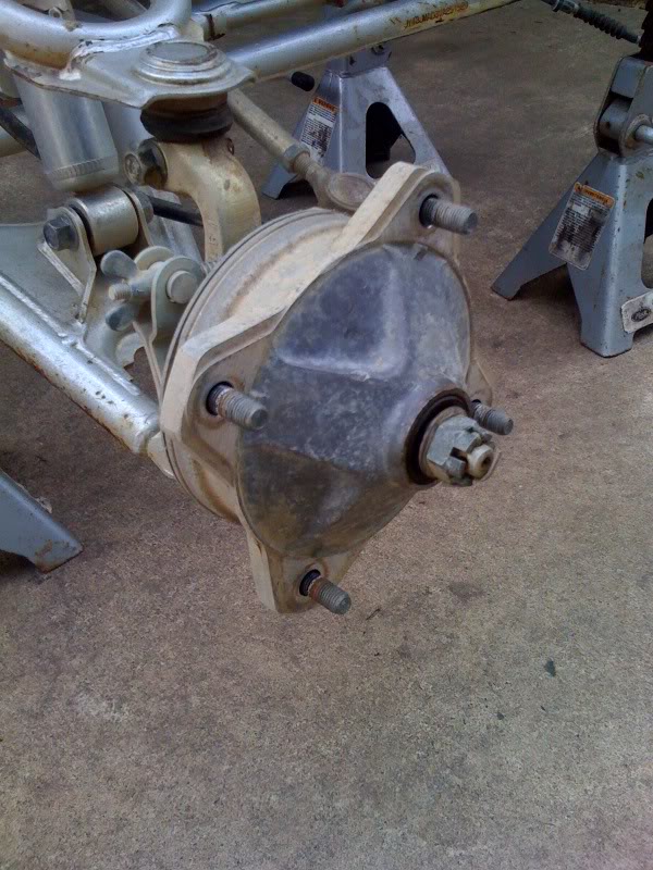

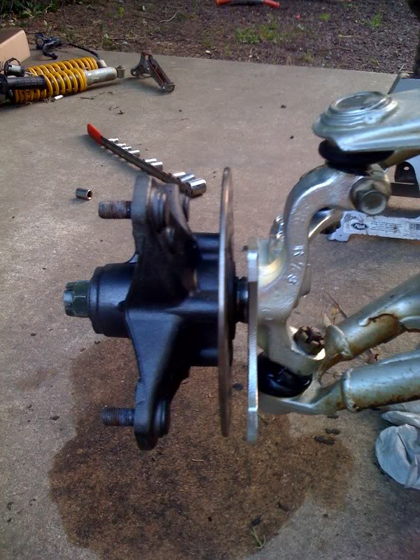

Well as some of you know I bought a set of Norman420 front hydro conversion spindles. They made the job as easy as 1 2 3... Took the old spindles off and they went on just as simple. Then slid on the Shee front hubs and rotors right on like the old drums and tightend them down. They are a great way to convert your Blaster to front hydros.. They come zinc plated and with hardware.
I would just like to thank you Norman420 for making it so easy and at a great price!!!!!!I:I
The hardest part of the install was figuring how to get the tierod ends and the lower ball joints off. I went looking in the tool box for a puller and I had this 2 finger puller. It got one tierod end off then bent the center pin tool useless. So I went to Auto Zone and got this 3 finger puller and it took seconds to pop them off and dint ruin the boots!!
