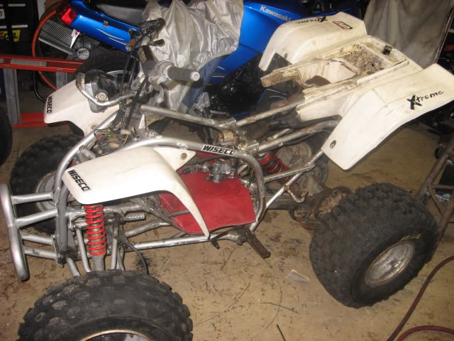

Hello all I just recently acquired a 88 blaster basket case to build for my wife. Luckily all it needs is a topend rebuild, rear axle bearings and the swing arm pivot bearings and seal kit.

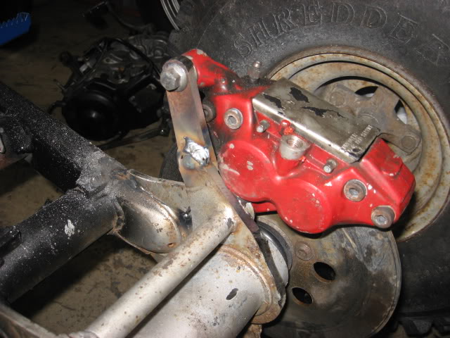

I started tearing it down while I wait for parts. The first mod I have done is stretch the swinger 4 inches and in the process of hydraulic rear brakes got the caliper mounted and now modding the rear brake lever for a brembo rear master. Now i just have to hunt down a few more parts and replace alot of bolts.

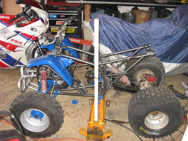

After some tear down, cleaning, paint, and stretched swinger.
