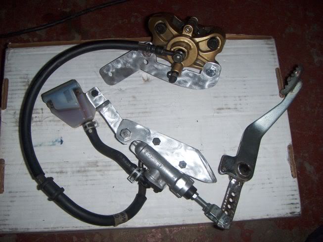

complete bolt on set-ups, dual piston calipers, awsome stopping power!!!
$145 shipped to you, just sold my last set-up, bidding on 2 more gsxr sets,
should be ready in around 2 weeks
pm me for details
complete setup, then on my sons blasty...........
Awks hydro kit is the best way to fix your brakes. Installed my hydro from AWK Sat. and it was very simple. I didn't want to bother with a stock system i knew was weak to start with. If you can turn a wrench to any capacity it will be a wizz!!!! I:I
so that's the hot ass brake set up i've been seeing around. I have the stock hydros(2004) but they look no where near that sweet. looks like I might have to sell them. hey awk if you read this will that caliper bolt right up to my set up? could i just use my whole setup just replace the caliper? that caliper looks and is better than mine being a dual piston
