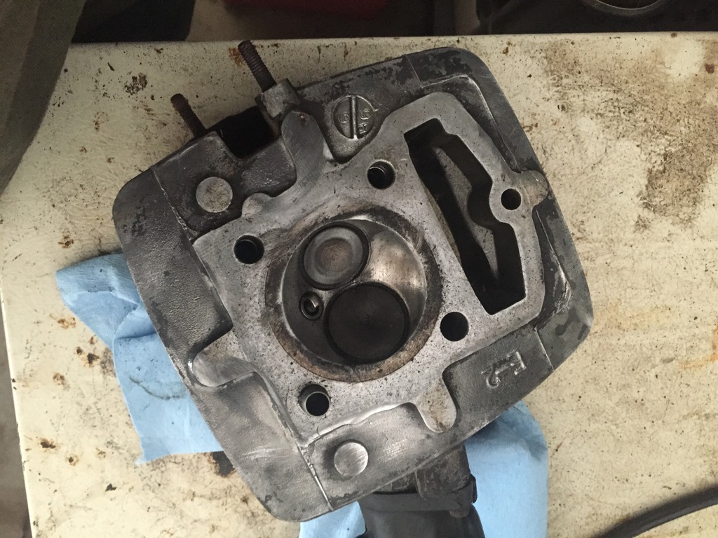

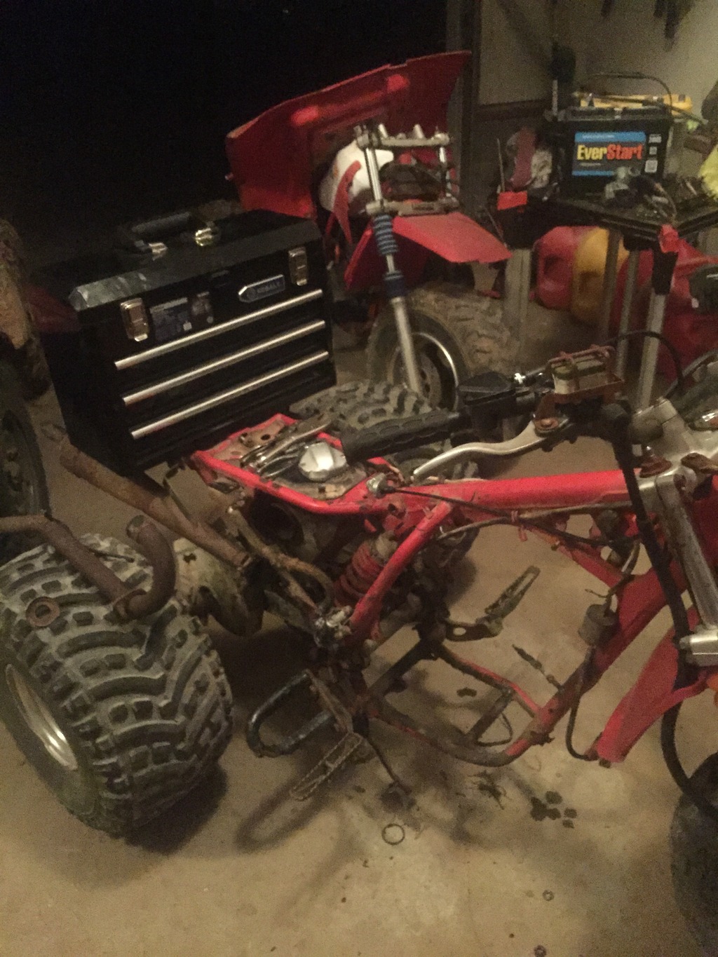

i bought another 200x for $100 he said he couldent get it to run brought it home put new carb on it and fresh gas and after a houre of kicking it it started but smoked like hell took it back to the garage had a 1mm over wiseco high compression piston and a xr200 head (bigger valves) and a 51 tooth rear sprocket so i bought a new topend kit and and timing chain should be here tomorrow pics will be up in a min

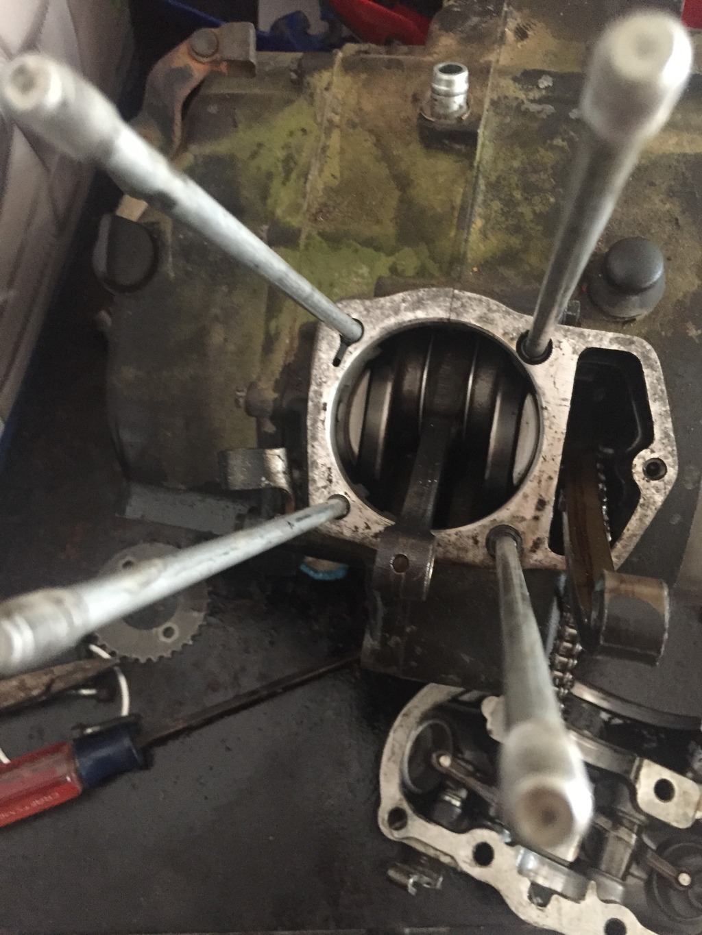

ok i have a problem i put it All toghter last night and this morning tried to start it nothing happend checked the timing it was like one or two notchec off so i fixed it went to start it and it feels like somthing is in a bindand i cant figure it out any ideas
i bot te binding issue figured out the kick starter was binding up so i made another gasket to shim it out a lil and it works good all the valves are good but its not getting spark even tho it has a new plug so im gonna swap out the harness coil and cdibox off of my other one and see what it does
