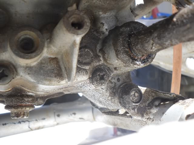

fixing to open the head up...and i noticed a lil oil spot under the quad. looks like it's leaking from where the shift lever goes into the housing. might i need a new seal there? i believe i have one on order...but have to wait (tuesday i think) i'm really starting to consider just a full tear down and rebuild just for my own peace of mind. I degreased and washed the engine last week, so this lil bit of 'ooze' is definitely fresh.
I've never done something like this before....so it will surely be a learning curve.
