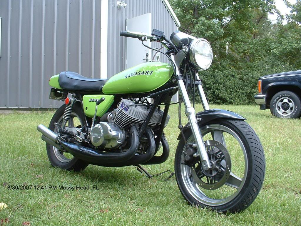

I have a lot of 2 stroke experience and bike experience ,but very little reed motor experience. I have only owned 1 RD 350 Yamaha , the rest of my 2 strokes have been Kawaskai triples from the 70s. Here's a pic of one of my bikes and the Blaster as it looked when I drug it out of the storage building beside my shop:
1975 Kawasaki H1 500 chassis, late 71 H2 750 engine (500 badges meant to mislead:-D:-D:-D ) 34 roundslide Mikunis, FPP pipes, Neville Lush racing ignition, Dunstall rear sets. Front forks ,mag and braking system late EX 500 Kawasaki , early Ex 500 Kawasaki rear mag, approximately 100 HP. 130MPH in about 11 seconds. Stage I porting by yours truly ,running Bel Ray SI-7 though the pump.

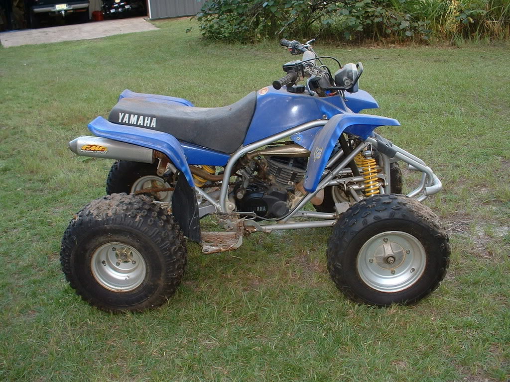

and the Blaster:
FMF pipe , K&N air filter main jet 270 pilot unknown, pilot airscrew at 1.5 compression 95 cold .115 after 4 hours of kicking and cussing The Blaster will run for about 2 seconds then die , cleaned carb , good gas ,all kinds of spark when I pull the plug and lay it on the head??
