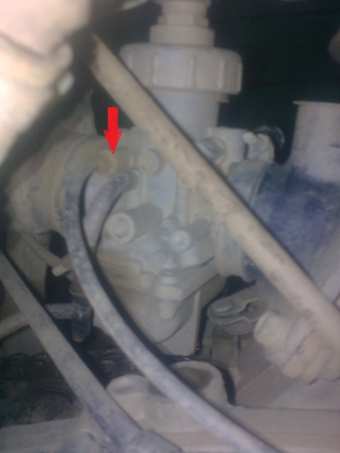

I pluged the carb today I had.trouble I didn't knoe whitch one was it there was like two spots thar looked like a hose for the oil could go there how do I tell witch one? An the air filter is brand new less then 5 rides with it in there
here it is :
RED arrow:
Thanks that the picture i needed i plugged that spot my carb looks a lil diffrent but that helped a great deal... as for that other open hole should i plug it to it looks like its running on the other side of the choke kinda like its directly behind the pull lever for the choke?
A pic of the other open hole on your different carb, would help greatly.

im thinking its stock its an 03 blaster ill see if i can copy an paste a carb that looks like mine off google or something im looking now
go to thread please id this carb for me by blastrmastr240... the carb looks like mine... there is a black vacume seal ther thats the one i thought was my oil line so i plugged that with a red vacume seal looks almost exactly alike the hole im refering to is the one on the right side an im pretty sure mine doesnt have the hole pretty much next to that black peice it just has a hole on the left an the right i have the left plugged right unplugged i hope that make sense if not let me know what u got out of it an ill try an explain better
mine is the same one as webmonstros i jus think i was confussed with the wires running also both holes im talking about are on the side opposite of the choke pull switch or what ever
alright well thanks did u look at that other thread i think thats right an that the one i have plugged so i think the carb an the exhaust are completly fixed im gonna work on gettign the leakdown tester an ill post another update
