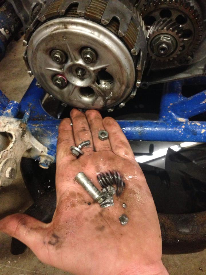

So bought this blaster 650$ top end was rebuilt everything was working fine till i went for a little 45 minute drive. clutch cable stopped working it was loose so i started to downshift witouth clutch .. and i heard a little noise and it stopped working like i turned the power switch off. now wanted to start it again everything was seized.. tought maybe i blowed the motor but when i started to take off the side of the clutch side i noticed bolts stripped and everything was broken.now i wana know the prices for all the parts i need 550$ for everything they told me. what you guys think i should buy my parts off i dont trust ebay...and i really like 2 strokes dont wana sell it or anything and for the future maybe buy performance part or make it more nice! thanks boys

the loss of clutch lever points to the center adjusting nut came off, and appears to have been caught between the sping bolts and the clutch cover = implosion.
looks like you'll need a pressure plate, probably have inner clutch boss damage from the bolts breaking off or being ripped out of the threads, and probably easier to find a full set of springs bolts, versus just buyin the 2 you need.
you really need to pull it completely apart to access the damage and make a list of parts. a trans flush with deisel fuel or kerosene should be done too, to get any shrapnel out of there

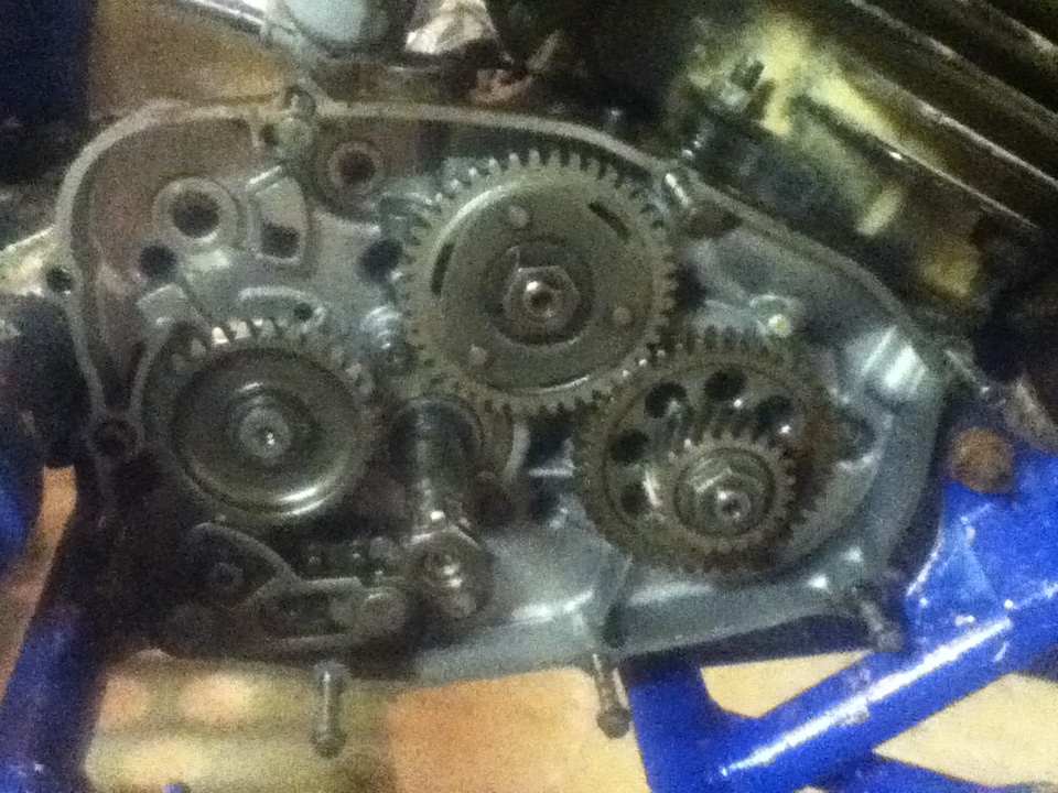

i took appart pretty much everything and cleaned the inside now i wana know should i take out anything else ? i mean it looks clean to me . it only did dmg where the clutch kit was.. i mean the rest looks fine to me.
