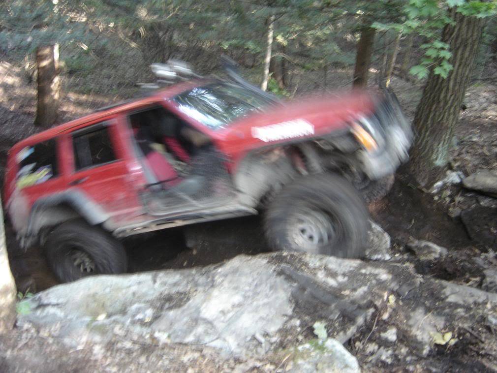

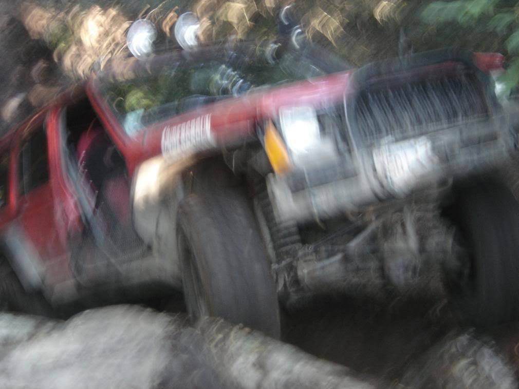

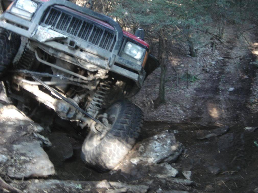

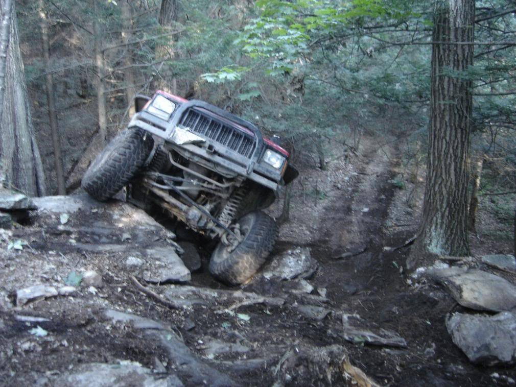

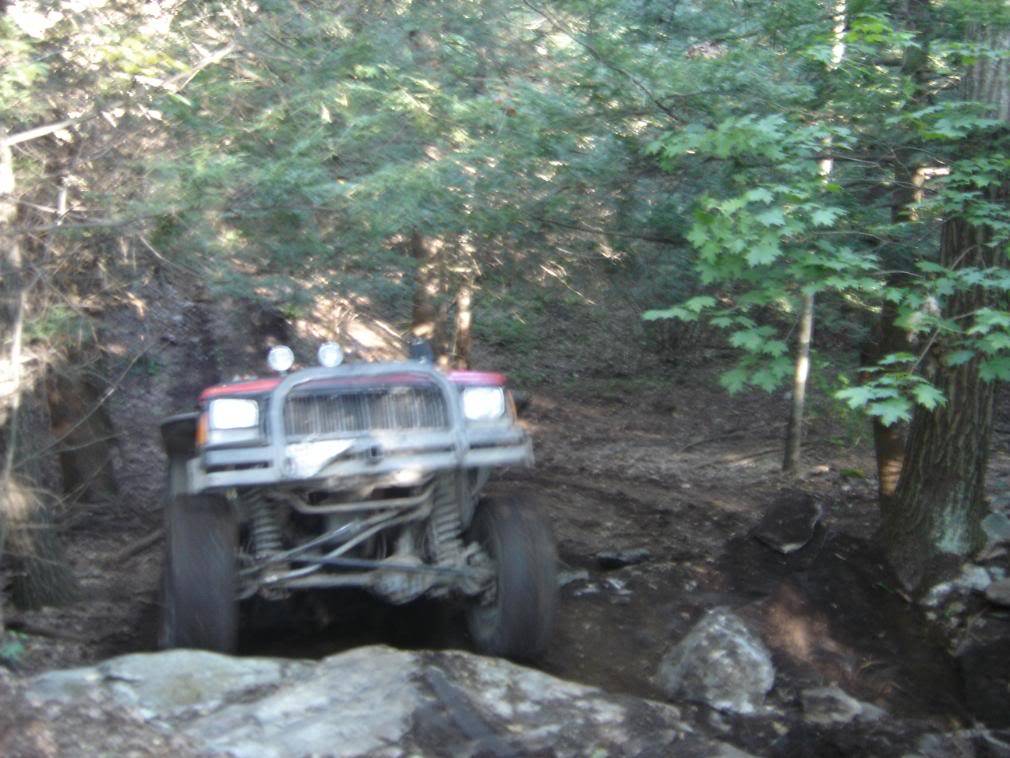

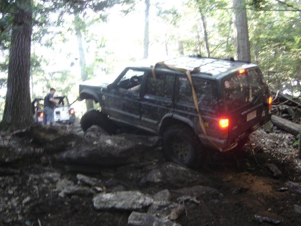

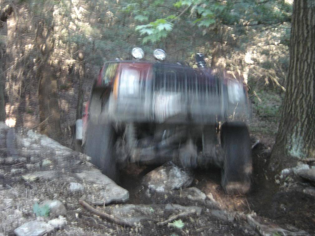

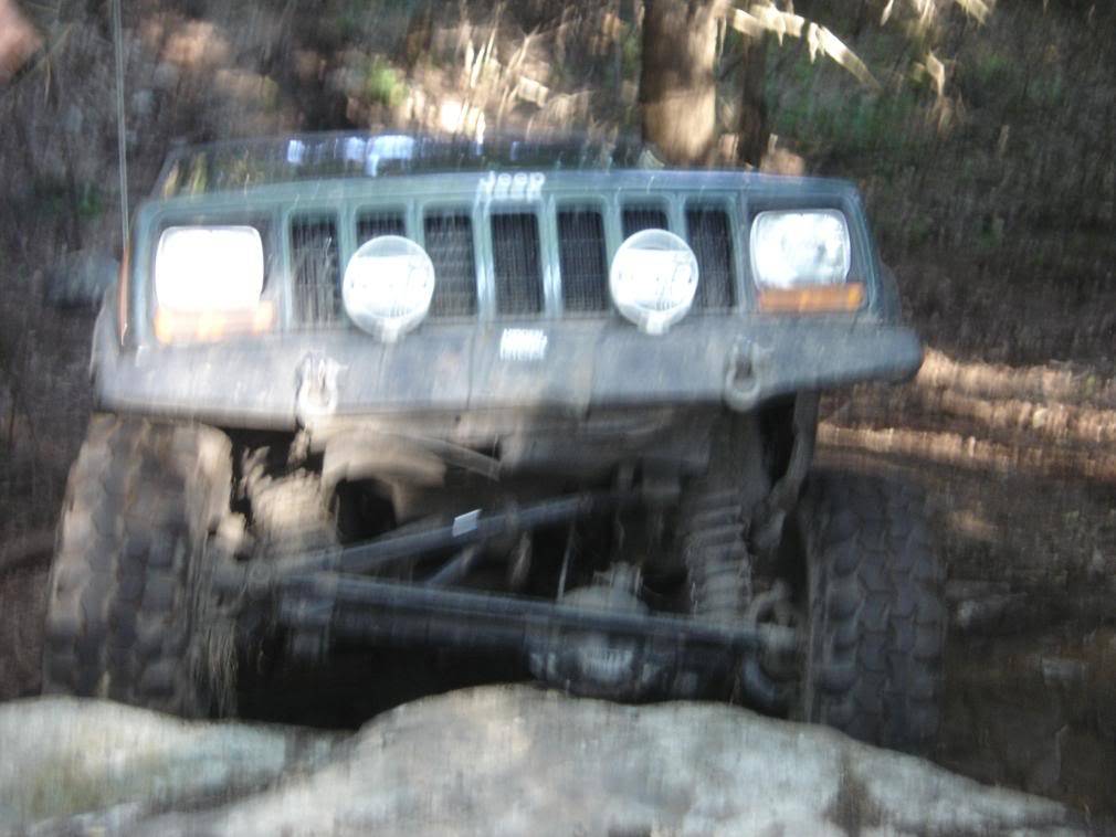

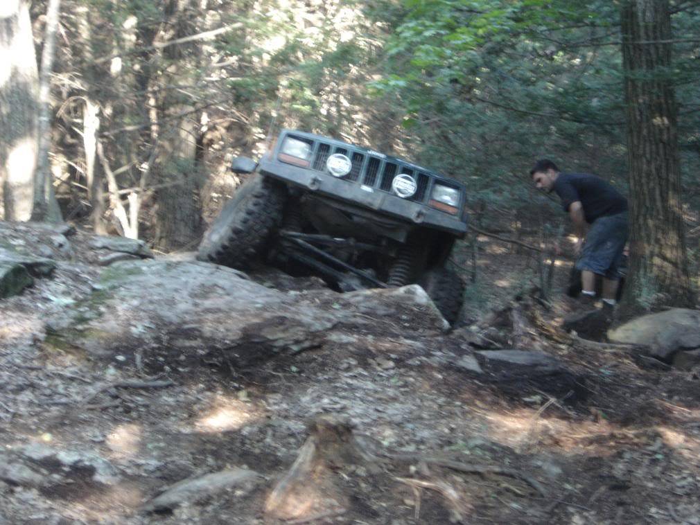

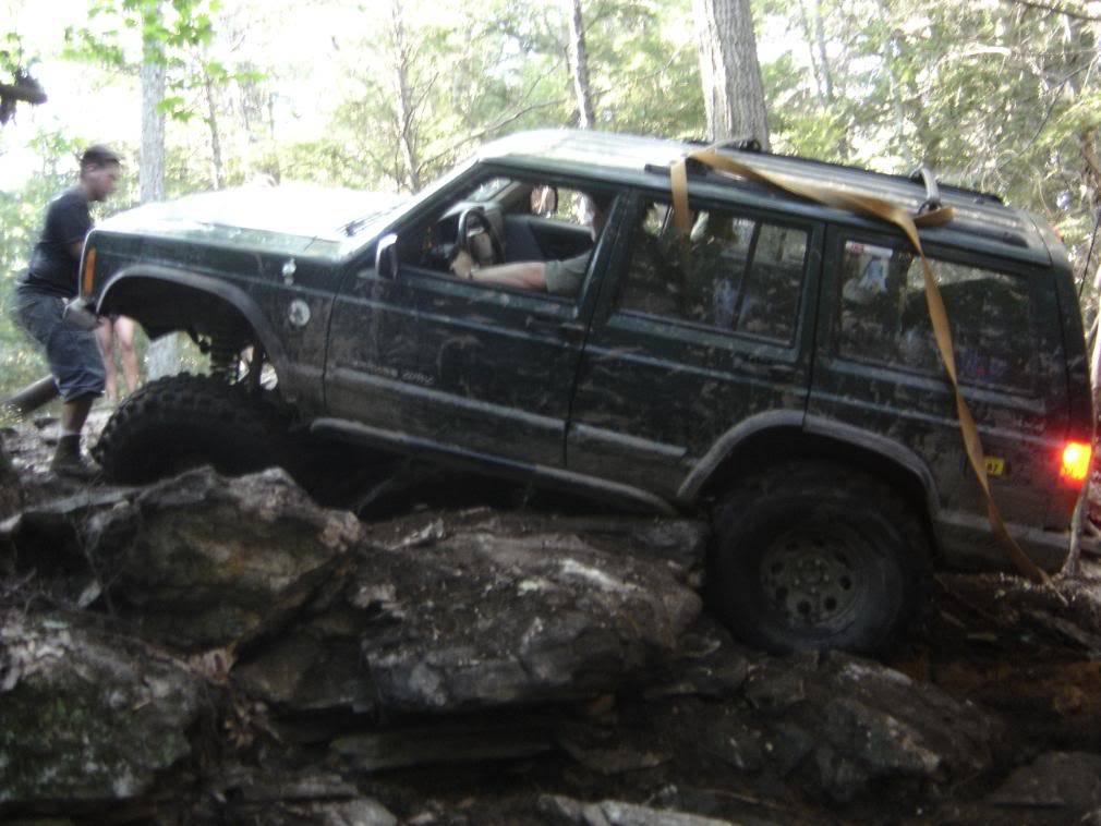

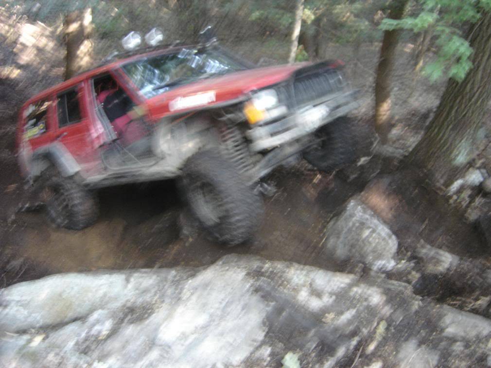

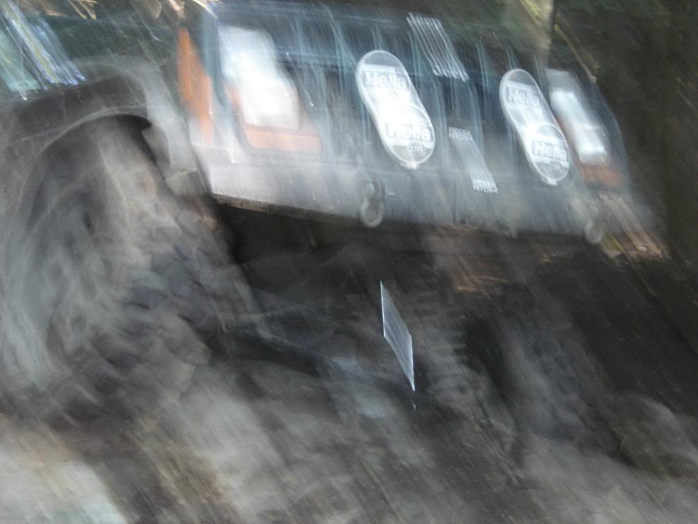

Oh yeah, people always love this pic...
I hate mud, by the way...

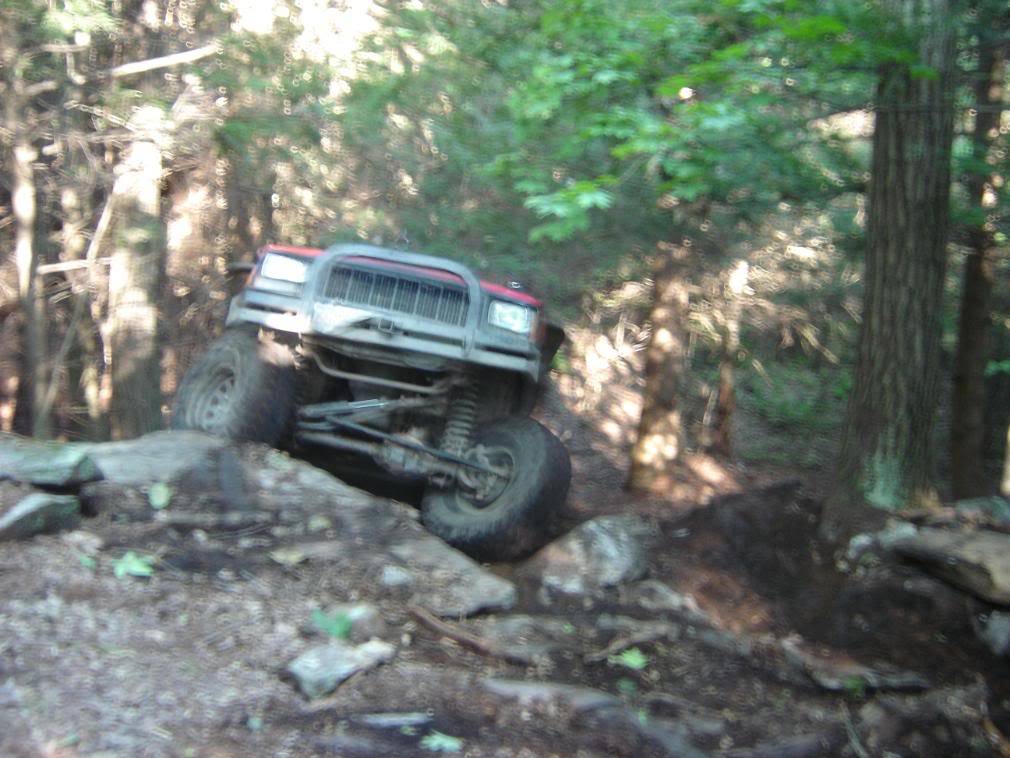

and the red chevy in the backrounds is my bro's he got a 6in lift but is waiting to find a solid front axle cause he wants it high.. and waiting on his 496 that should make 550hp and with a blower 750!than my junk haha

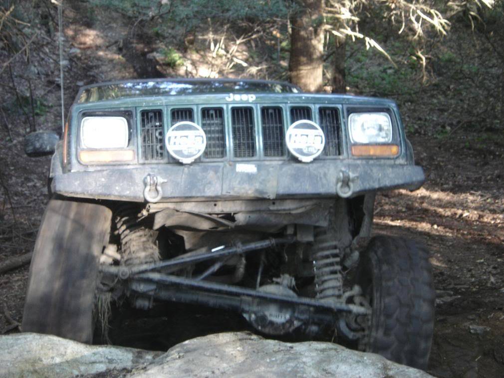

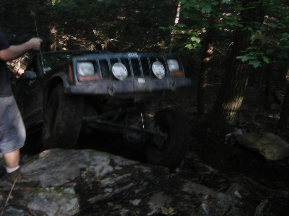

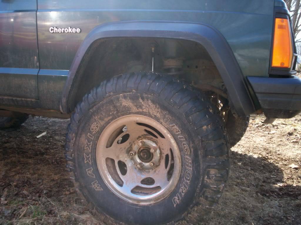

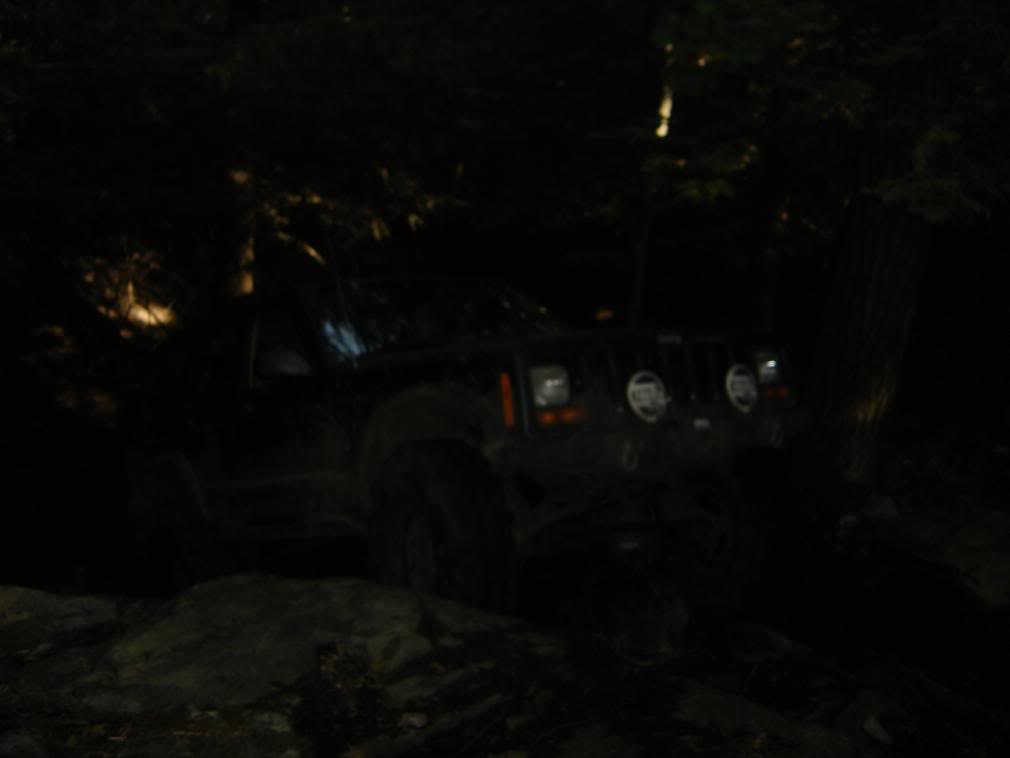

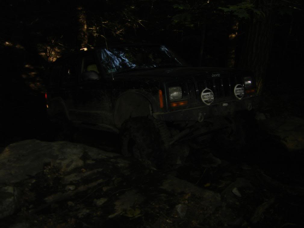

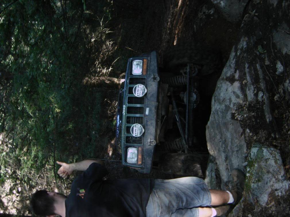

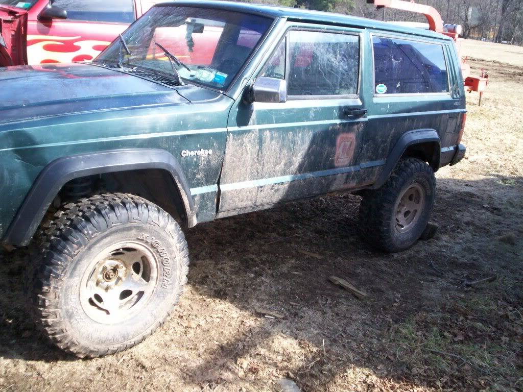

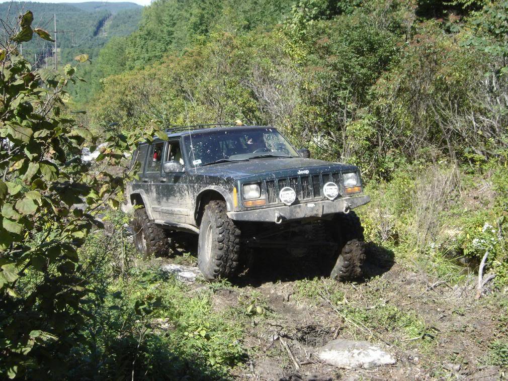

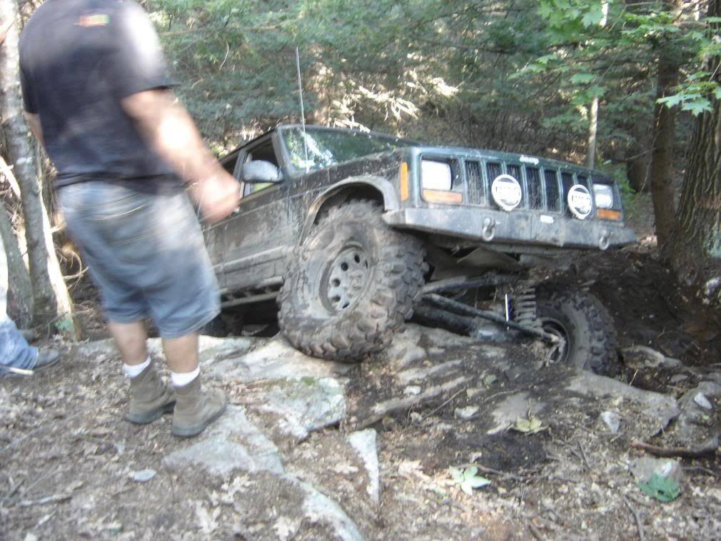

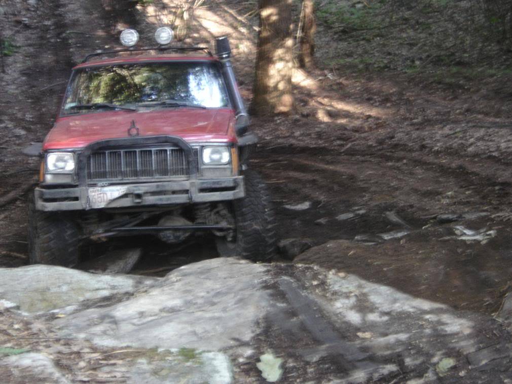

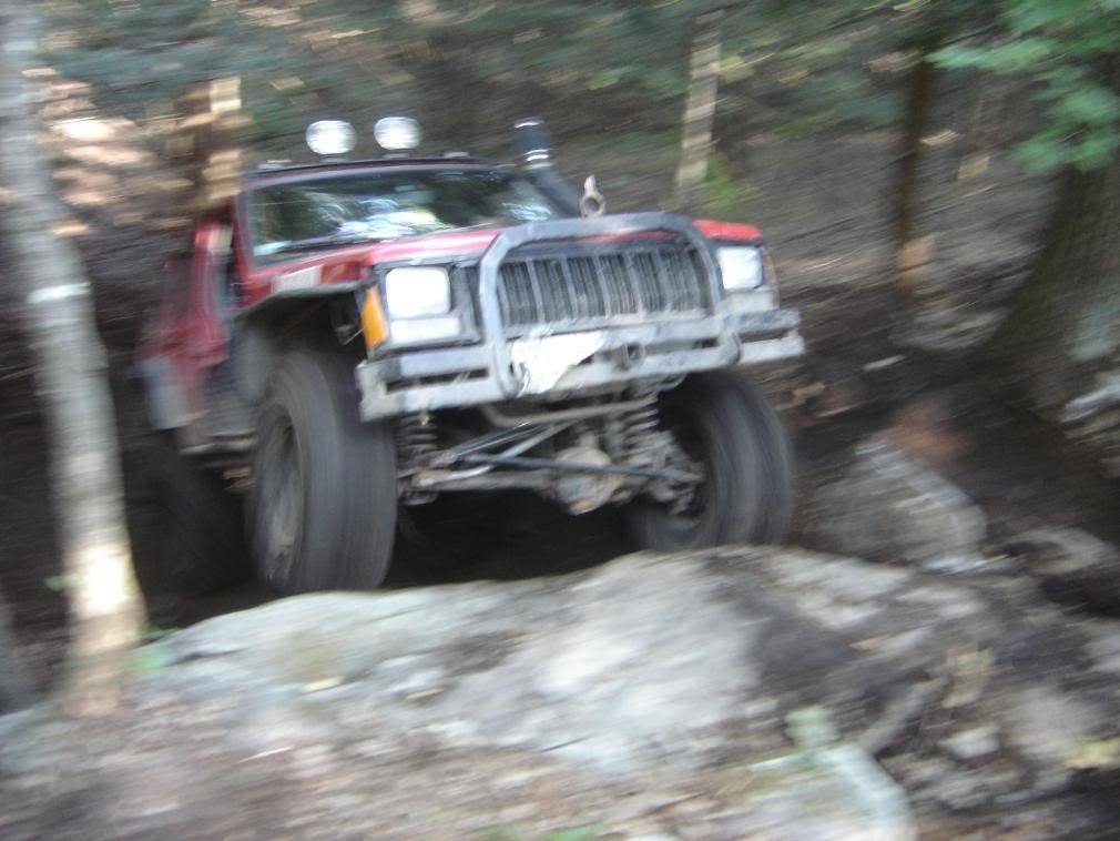

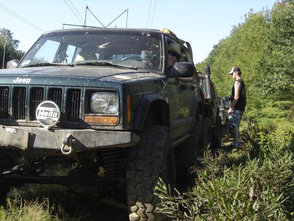

What size lift and tires on the Cherokee?? Those don't look like 35s! Shouldn't take much money or time to get that thing wheeling!! Make sure he swaps out the Dana 35 rear axle for an 8.25 from a 96 or newer XJ or a Dana 44 from a 87-89 XJ. Or, you can get rear discs if you swap in an 8.8 from a 95 or newer exploder. Grab one with 4.10s and regear the front too. Just have to weld on spring perches and get an adapter for the drive shaft.
Yeah, you need to put a solid axle in the pickup if you want to lift it...or wheel it. Not that hard if you can weld and fabricate.
4in lift not sure of tires but now i got a guy that wants to trade a 91 suzuki sidekick for my dirtbike... ill lift it and put some tires
