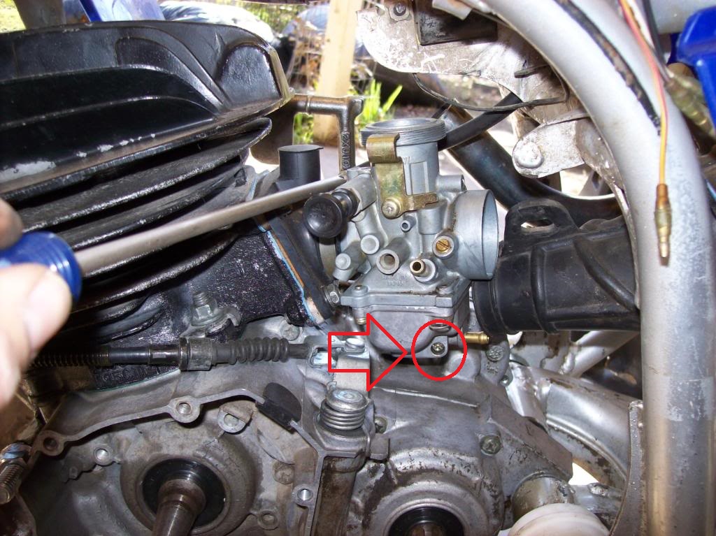

Ok First of all quick question have you done anything to it like tors removal kit or anything if so make sure u have everything removed becasue i didnt and that casued alot of problems. Second i would remove the reeds clean them check for cracks and damage , clean the carb , make sure there is fuel running to the carb easy way is open the screw at the bottom of the carb see the picture for details. if thats is good then check spark plug make sure its not gunked up or anything . If that all that doesnt work then there will be somthing else wrong.
