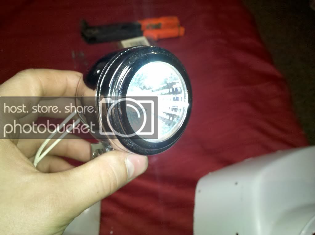

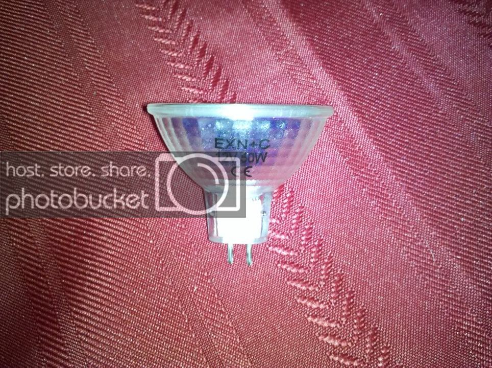

ok so i bought these lights for my blaster at walmart its called the platinum series burner. and i know alot of you guys are running them. problem is i need lower wattage bulbs like 20w or 25w so the stator will power them both. I CANT FIND THEM ANYWHERE!! AHHHH!!! im ripping my hair out here. Cant find them at walmart or any autopart store or online. So if someone out there has them at their walmart or knows where to find them I will gladly pay you to get them for me. It would be greatly appreciated and i will give you mondo rep and im sure lots of others will too I:I thanks guys heres some pics so you know what im looking for
light itself
heres the bulb i need

they have the 20 or 25 watt halogens too, if you run them leds, you'll get away with 700 watts, the listed wattage on them isnt the usage, but the equivilant output, those listed above prolly only pull like 1 -2 watts
go with the halogens, led's are bright, but dont throw the beam very far
just my .02
heres 20 watt halogens..................
Shop Philips 3-Pack 20-Watt MR16 Halogen Flood Light Bulb at Lowes.com
Reactions: acezeesawtooth
They are at Wally World. Just go over to the next department where they sell all the home sh*t and there or where they sell replacement light bulbs and get an MR16 20W halogen flood bulb....end of story.

one more tip.............the outer rings on thise lights just love to "jump off" on the first ride out, just ask hudak, dualstroke, and a host of others, most use a wrap of tape, but that may look too tacky for you < hahahaha tape is tacky !!!!!!!!
so look into a spot of silicon or "Amazing Goop" < google it if ya don't know, best glue on earth !!!!
or possibly a set screw of some sort to hold the lens and ring on, or you'll be doing a return loop to look for it/them
To hell with thiose lights.lol I ran a set for a few days and thats all they lasted.Awk already hit on the points to make them last,all I will add is the rivets that hold them to the brackets will come loose also.I would through bolt them so they last,the outer rings with tape or silicone etc is deffinatley a must also.If you need any parts I may still have them at the bottom of the bin.lol They will work fine if you do these mods to them,otherwise you will be buying a set of trail techs.IMO
